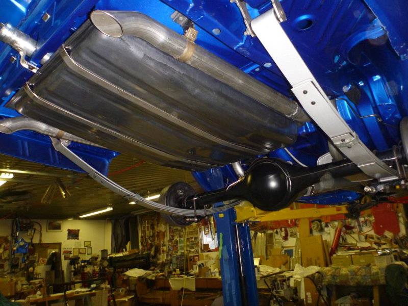

Or Canadian... everyone tells me chrome tips where Standard on a '69 Bee... but I know where this car has been my entire life.
Plenty of California cars got tips, very few were deleted by law, 340’s got tips, 383’s got tips, 440-4’s got tips, 440-6’s in 69 got tips...426 Hemi’s in 69 got tips.. Beginning in 70 440-6 & 426 Hemi had their tips deleted due to noise emissions reduction... But some dealers did add them to sell cars....
