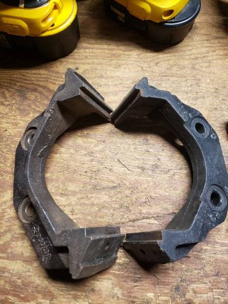

Have 2 sets of caliper brackets,anyone know what these are for and any value
10.9” disk brake A body slider caliper brackets

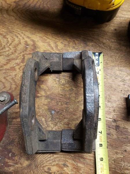

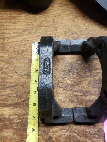

The longer ones the shorter ones not sure can you measure the hole spacing on each set where they bolt to the spindle. Stand them up on a flat surface and measure up to the center of one one of the spindle bolt holes as well.
the black ones could be cordoba 11.75 disc brackets. 3 1/8 is 10.9 rotor bracket and 3 5/8 is 11.75 rotor bracket.
they did make an H.D. Bracket for the 10.9 rotor as well. Grab the measurements
