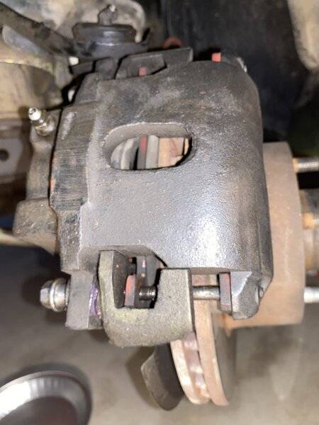

What are your favorite lubricants to use on disc brake caliper pins?

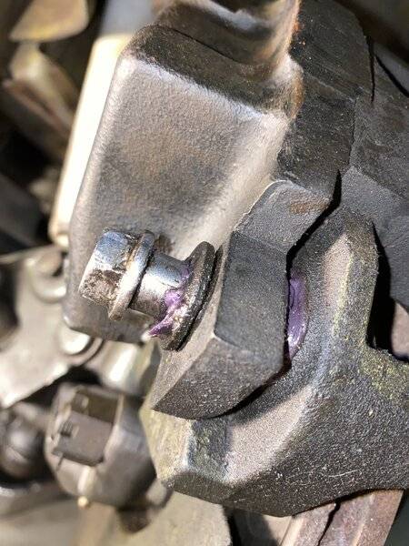

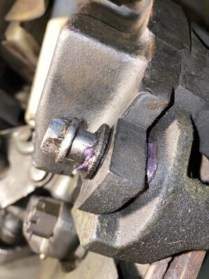

My pins had a purple colored lubricant on them when I removed the calipers. I’m wondering if it was the Permatex lube in the attached photo? I need to buy some lube for the pins, before I can reinstall the calipers.. The pins were cleaned by Karps and are dry, with no lube.
