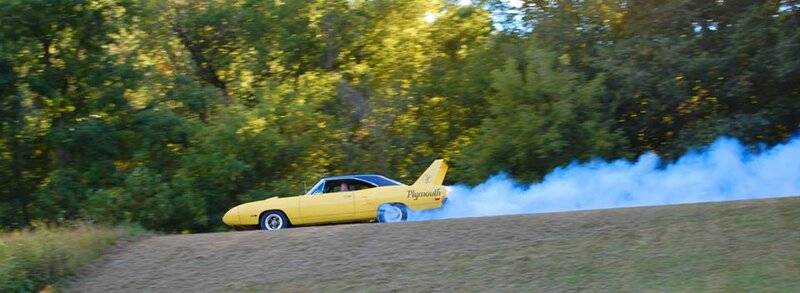

My super bird there’s a 500 stroker in it. I put a new set of SuperStock Springs of it I couldn’t get traction with them on the street. I put on a set of caltracks . Night and day difference The picture was when I had the super stock springs on I was doing Around 40 miles an hour
Automatic or Manual transmission?
I'm lusting after your car! Rear gear and final drive ratio? Any suspension changes up front? Brakes?

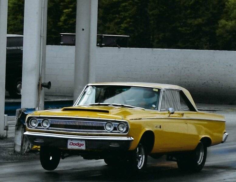

My heap is a low 11 second stick shift car.
With the stock spring, it wrapped up so bad the u joint ripped out the the yoke first time I dumped the clutch.
After that, went to XHD springs with a snubber, unclamped, cheap truck shocks, and it worked really well for what it was.

The super bird has a 727 auto and Dana with 3:54 gears. Motor is 11.4 Compression The car Has only 1 cheap paint job. Original vinyl top. I don’t ever plan on restoring it.
