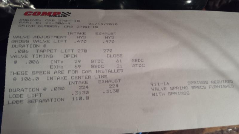

Nope not a hemi cam its a cam for a 383 or 440 supposedly. I know others that have used this came on here maybe I should pvt message them and see if they had any issues using their stock bolts. I'm wondering if maybe the cam was tapped to the wrong size maybe. Here's the came card for it don't think there is any relevant info. 20150630_180714.jpg

Nope not a hemi cam its a cam for a 383 or 440 supposedly. I know others that have used this came on here maybe I should pvt message them and see if they had any issues using their stock bolts. I'm wondering if maybe the cam was tapped to the wrong size maybe. Here's the came card for it don't think there is any relevant info. View attachment 268237

you don't need a 3 bolt set-up with that small of a cam. a 3 bolt comes into play with high spring loadings. 3 bolt cams didn't come into play until the '66 street hemi. the 65 race hemi was a 1 bolt, but used a heavy valve spring that may have caused some failures. the 64 and down race wedges used 1 bolts but didn't have high valve spring loadings like the hemi's. the 69 6-pak was the first year for 3 bolts and to my knowledge 6-paks were the only wedges that cam from the factory with a 3 bolt.
as for that cam i'm not fond of them. they're very short duration with too much advance ground into them. it would be ok for 8:1 compression engine, especially a 383, but make too much cylinder pressure in anything around 9.5:1 compression. simply put, they close the intake valve too soon.
