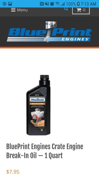

BluePrint Engines have Break-in Oil.....I bought a carton for my engine. Contact @Johnny Mac - Vendor here on site :D

A true break in oil is better.
https://blueprintengines.com/products/blueprint-engines-crate-engine-break-in-oil-1-quart-bpp710
