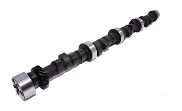

Cam for 440 street build

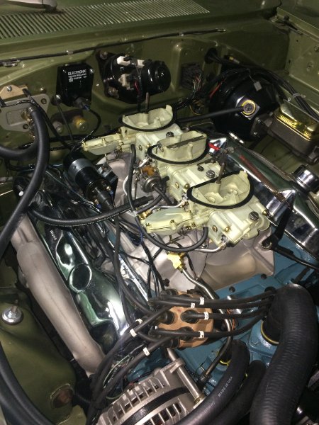

First thing is lose the pistons and build a quench motor, I did and its a beast. 915 heads ported/polished, light weight JE/SRP pistons, Mopar .528 Mech Cam, 6 pack setup, perfect .040 quench with .020. steel shim gasket. 520 HP on pump gas with dyno headers.
I'm guessing that's a bit over 10.5:1 with the 915's. Does that cam duration/overlap bleed off a bunch of compression?
