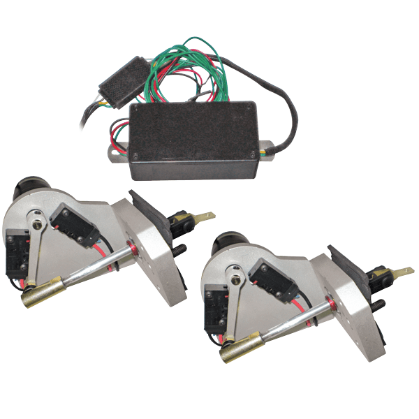

      Be sure to do a vacuum leak down on your headlight actuators, I found one of mine wouldn't hold vacuum. After costing the replacement actuators ($265.00 ea.) I decided to go with the electric conversion kit. Simple kit, easy install, a vacuum leak is still a leak brother...just sayin

        Thank you brother! That was another question I had... I figured the electric kit would be a pain to do. Thank you for clearing that up
