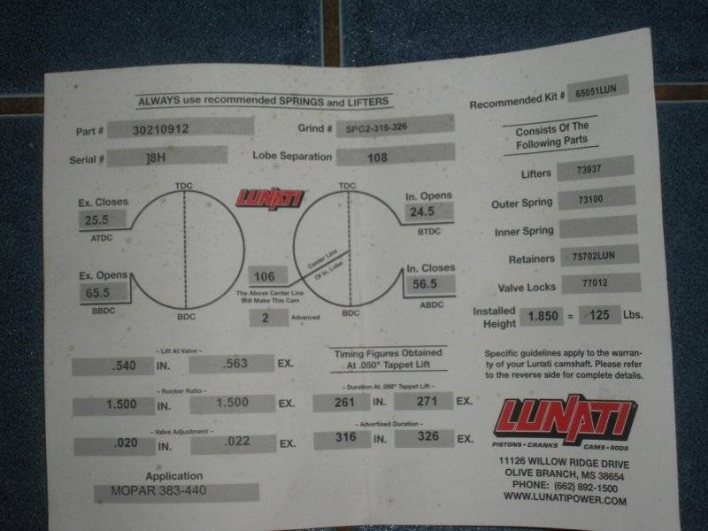

I have a Lunati solid flat tappet cam in my car.
The numbers make it seem pretty wild but it idles with only a slight lope. The car was faster than ever with this cam when I ran it last time. I have Howards EDM direct oiling lifters.
It is too much for a low compression stock stroke 440 but the Lunati name is a good one.
