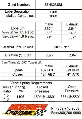

Hi can some one recomend a camshaft for My 440 in My 70 cuda.
Its a 440 030 over. IT has old 2266f trw pistons forged crank and rods. IT has stock 906 heads now and a [email protected] 484 lift mp camshaft. But i have a set of trickflow 240 heads and 1.6 roller rockers i want to use on this but need a New camshaft.. I have 3.54 rear end and a 2800 stall 10". I have a edelbrock rpm and a 780 hr quick fuel carburator.. I also have a nitrous plate 100hp.
Its a street driver with a cuple trips to the strip.. I have look at the voodoo 703/704 but i dont know if they have the lift needed for the 240 heads? I see some grinds from Howard has more lift but i have No clue at this?
Any recomend camshaft here??

Ive had fairly good luck with Hughes camshafts. Something like this one might work well with your trick flow heads.
