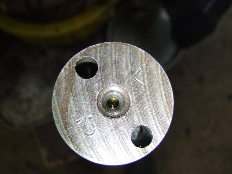

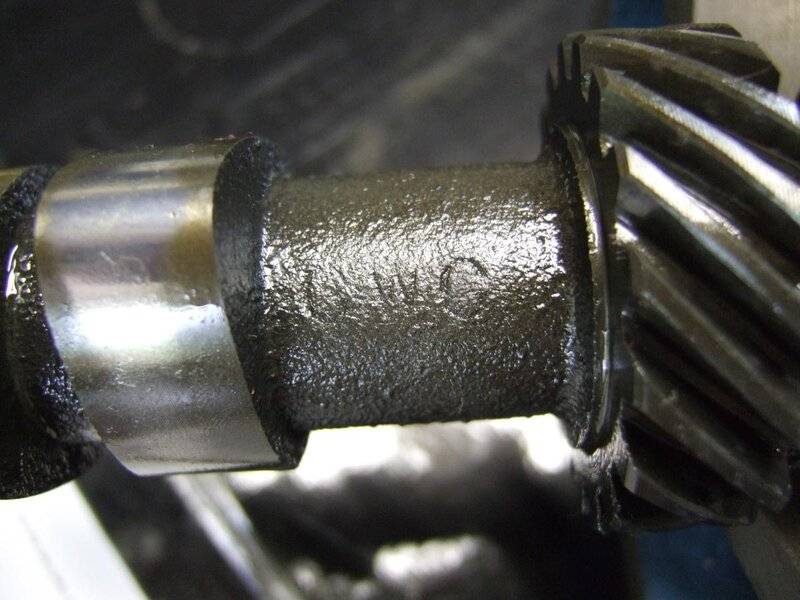

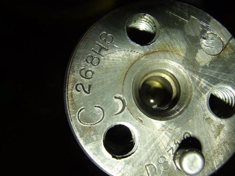

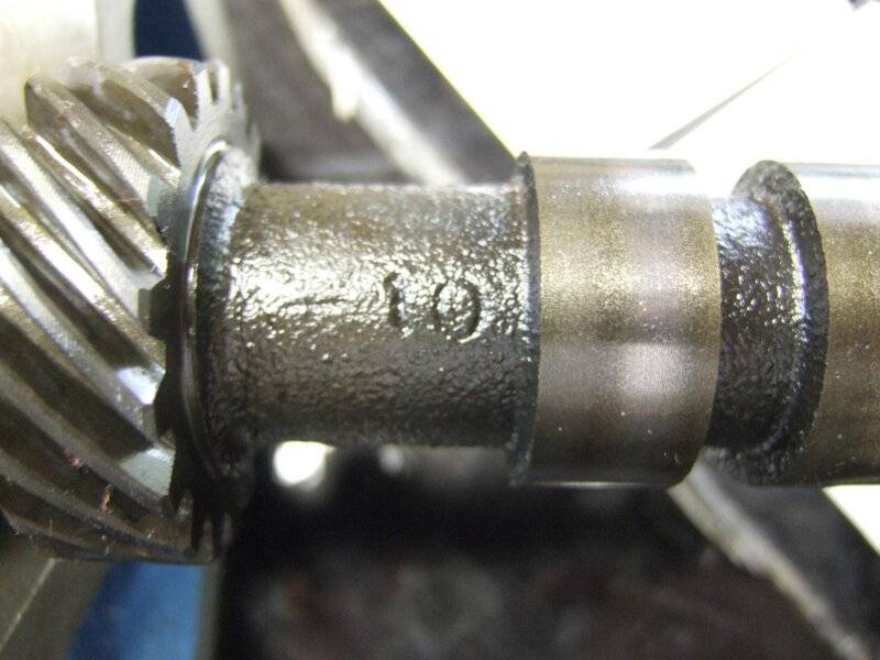

Could you give me some help to identify the camshaft from my 67 440HP?

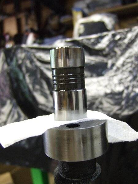

I attached the lifter image as a friend told me he thinks they are Crane Cams lifters thus perhaps cam and lifters were a set.

I think its likely a comp cams 268 with a 108 degree lobe separation angle.
Chevy grind.
What he means is that it is a Chevy lobe profile, ground on a mopar cam blank. Chevy uses a smaller diameter lifter than Ford or mopar, so if you grind a safe profile for a chevy, it can be used on anything.
What he is saying is that your cam doesn't take advantage of the possibility of a better grind for the larger mopar lifters.
that is a regrind. see the dowel cut and ground off that is not what i would put in my engine call a cam company and have them grind a new one off cam for your engine dont buy off the shelf cam shaft mopars are different from any brand -x
Yes, indeed I understand. I'll not be putting it back in.
