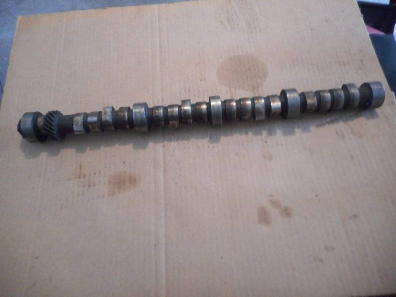

I have a big block camshaft that has been in my parts cabinet for many years, and I can no longer remember what engine it is from. The casting number between the gear and the first lobe appears to be 2402722. Any help is much appreciated.

On the end of the cam, numbers should be stamped into it.
OR, It needs the cam doctor treatment so you’ll find out the full specs of the cam. Option 3 is to send it to a grinder to be ground with something closer to exactly what you need or want.

I have no intention of using it. All I asked was if anyone could ID it. :)

I've never heard of "grind numbers" being cast in. How would a foundry know how the core will be ground?
That is a factory casting number for the stock 383-440 cam, the other stock cam they made had last 3 casting numbers of 454
