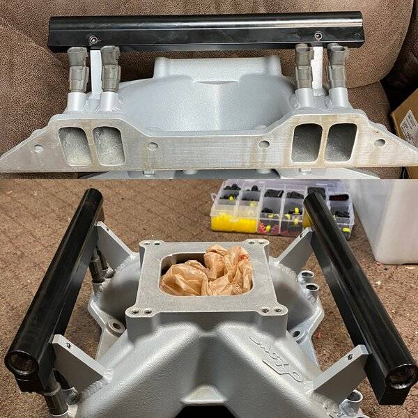

How much I love the ole school feeling and what not of the car. I can’t stand ******* with a carburetor. So I’m going mpfi . Just waiting on parts now . The car will be on e85 with a flex fuel sensor so I can run 93oct and it will adjust on the fly .
I’m hoping to get the rest of the parts over winter time . everything is on back order unfortunately.

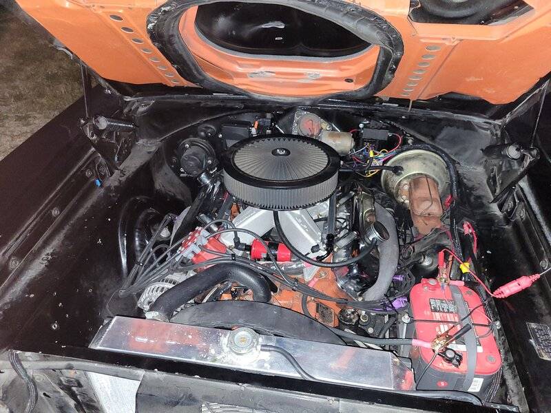

Fuel in injection works great IF it is designed and installed properly. My 70 has a throttle body FAST system that I used when I drove across country. Indispensable if you are going to drive a car regularly!
If you haven't planned on it, I STRONGLY suggest you get a fuel tank with the pump in it, and route a return line to the tank as well. Yes, this can be a royal pain in the a$$ to install, but is really a key part of the FI system people seem to overlook. Why is it important? Fuel pumps push, they don't suck. Also, the fuel in the tank keeps the fuel pump cool. There is a reason every new car has an in tank fuel pump! Also, the return line keeps fuel cool and helps assure the system has good, consistent pressure.

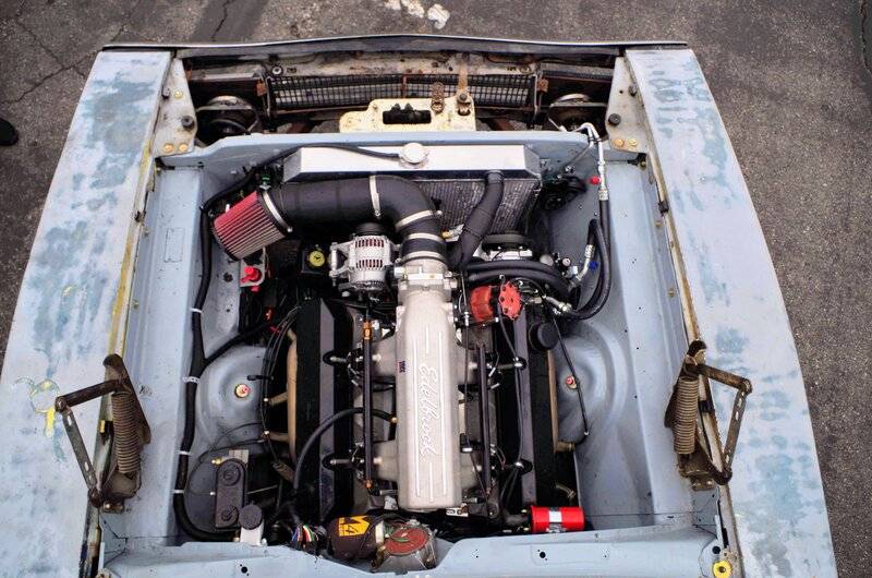

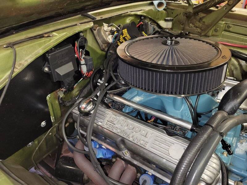

I have installed 3 Edelbrock Pro-Flo 4s. Great system.
I'm an old school carb guy, but I think in this case, go big or go home applies. If doing fuel injection, do it properly, listening to the advise of others on this forum who have done complete systems. Just my 2 cents. ruffcut

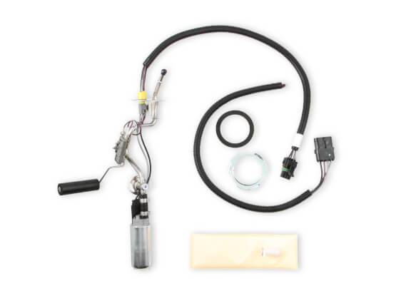

This 12-314 does an internal pressure relief/regulator and does not use a return which is not optimal. I think for the extra few dollars when you’re already spending a couple grand you should consider the EFI tank too as there a sump/baffles welded into it to prevent starvation. I think The gel mat pictured here is a compromise
I am surprised Holley sells that.. I wouldn't use that on a Car I plan to drive Hard.. A commuter car with under 300 HP, maybe..
I agree, even when I called them and asked about it the told me the other method with a full return is ‘preferred’

Yes I’m not new to the horsepower world had buick t-type on e-85 and 800rwhp crown Vic on e-85 .
I’m Using the Holley tank and sending unit . Putting in a 525lph pump in tank instead of the 400 they offer .. using a holly 1050cfm thottle body and Holley terminator x stand alone
