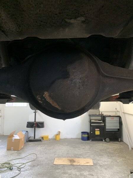

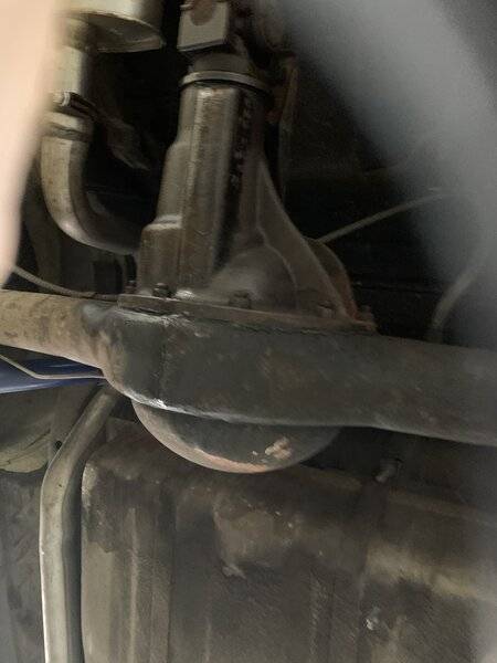

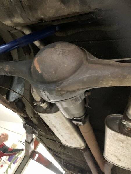

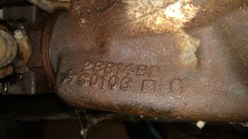

can anybody please confirm this a 8 3/4 rear differential and name a part?
Michael_
4:12 AM
Jan 31, 2019
1,544
1,574
Germany
See pictures.

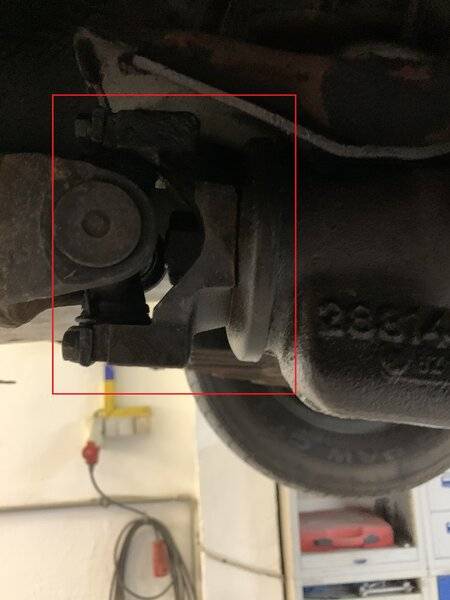

I think its a 8 3/4 rear axle/differential, right?
And how is the other pictured part called?
Would need that replaced including a new seal.

You have outlined the universal joint, part of the driveshaft, the output yoke and the axle yoke dust shield. If you are only removing the universal joint, no seal is needed.
Yes, that is the 8-3/4. Looks to be the '489' casting. Beefy.
If the last 3 numbers on driver's side are 742 I would contact drdiff for that pinion yoke seal.
I think you mean the pinon yoke and pinon seal?
https://www.doctordiff.com/8-3-4-pinion-seal.html
Mark the pinion nut location and number of threads showing above the nut (a picture helps too) before removing the yoke.
You should get this yoke holder and puller tool for this job:
https://www.summitracing.com/parts/...MIi97b0uux6gIVDtvACh2v5wOyEAQYCSABEgI7APD_BwE
You can remove the yoke with a different puller or carefully tapping the pinion off, and hold the pinion from turning with the emergency brake, but for $23, the tool is nice to use.
after replacing the seal, Re-install the yoke and tighten the nut to the original position you marked originally to keep the same pinion pre-load.
Be aware if its a 489 rear they use crush sleeves for bearing preload.
So use caution when replacing this seal and re torqueing the nut on the yoke.
ONLY on the 489 housing has crush sleeves.
We need the last three numbers in the casted numbers on the driver's side Before anyone can give you advice.
Only if it's a 489
Only if it's a 489
What does that mean?
On the Dr Diff web suite, you can select either seal depending on the case number.
When re-installing the yoke, you want the same pinion pre-load. Crush sleeve or shims, you want to put the same pre-load back.

What is the problem exactly yokes don't usually need to be replaced and it looks dry
Are they just wanting to replace the u-joint?
They say it leaks. I guess they cleaned it up.
I want them to perform a full service including change of differential oil and seal.
So they want to make it properly.
Preload on the 489 is done with a crush sleeve. Over tightening it will change the pre load. You are correct to mark the nut.
741/742 preload is set with shims and the nut is torqued to 150 + ft lbs. (I know fms says 240 ft lbs but thats overkill or just incorrect) The shims won't let the backlash change unless you add or remove them. Just tighten the nut.

could be the seal or the yokes leak sometimes as well . down the splines out through the washer nut combo .
