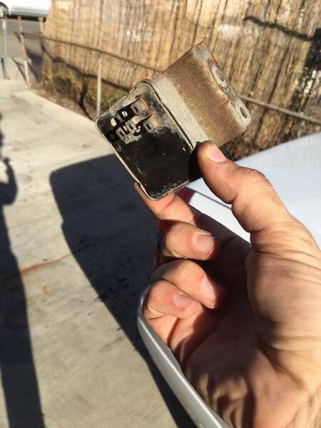

can anyone identify this mystery '74 Charger ignition part?
WheelsOfTerror
3:22 PM
Aug 14, 2019
176
69
Los Angeles
Hi Mopar friends!

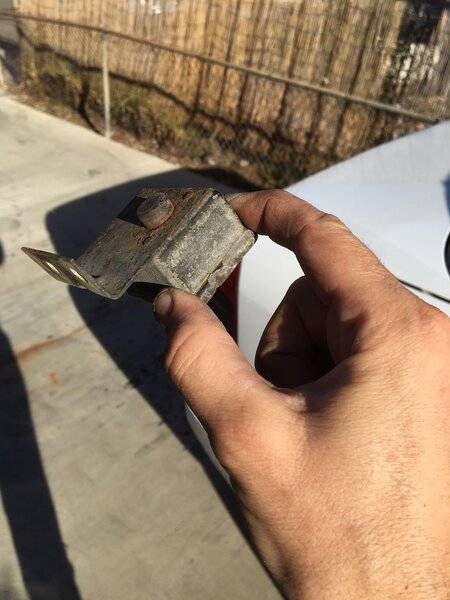

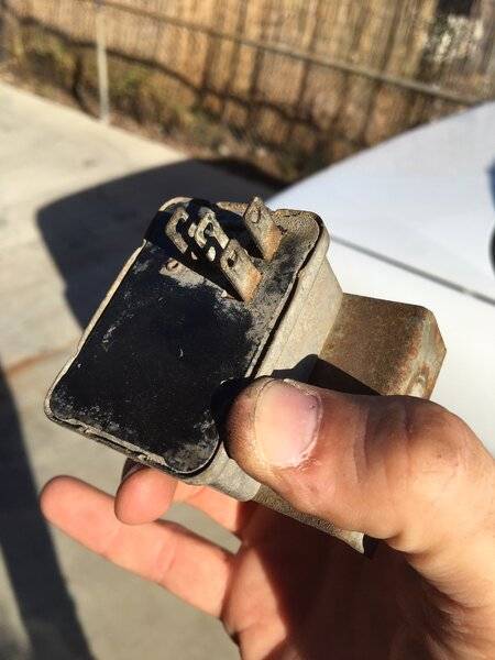

I was tracing my big yellow ignition wire from the key cylinder, through the firewall harness and followed it to this component- no part number, no nothing.
There's a rubber button on top; the wire goes in and out of this thing, and I think it might be my failure point. Anyone know what the hell it is?
I think you just saved me a lot of heartache staring at a wire diagram. THANKS DUDE!!
You're welcome, there is info and diagrams on that system here. Somewhere. Maybe google it. Member @Natcho is a very good source for info on the 74 as well.
you can bypass that fn thing by tying the two yellow/ black tracer wires together.
I got rid of it all together by running the yellow wire straight to the starter relay. that's where it ends up anyway
do I tie the yellow to the yellow and the black to the black, or do I tie them all together?
what did you do with the black wire?
I've seen Natcho weighing in on a lot of these kinds of issues- in fact I think this very one now that I know what I'm looking at. thanks for the referral. I have bypassed it, I think, so screw this little box. I had the same car one other time and someone had already tossed it. Now I know.
This is NOT really the seatbelt interlock relay ( althought lot of ppl knows it like that ), but the seatbelt OVERRIDE OR RESET SWITCH for the interlock system. Jumping out both yellow wires make work the system like this switch is allways activated, overriding the interlock system.

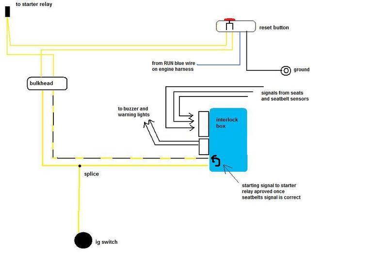

You could also switch around the yellow wires at bulkhead plug and will do the same. That would make the starter signal from ign switch arrive straight to the relay like on previous years, and keep at a side the starter relay signal wire from interlock box.
This is a basic wiring diagram I made long time ago about the starter relay signal route on 74s with interlock box on the way.
If you wish to get deeper into this, this is the master tech conference video about it. There it explains the seatbelts buckle sequence to a correct interlock system functioning. You still could check if it works or not.

Wow Nacho, thanks for that info dump- I think I'm going to bypass it, although I'll miss the buzzers- they did work prior to me chasing the ignition issue that lead to me asking about the box. If you wouldn't mind I might PM you if something else comes up while I'm chasing this issue down. I'm going to spend some time with the tester light and voltmeter tomorrow finding out why turning the ignition switch isn't getting power to the starter. Wish me luck!

bypass the interlock system at reset switch won't affect the buzzer warning system as far the interlock box remains connected.
