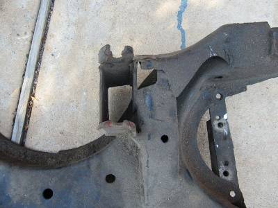

I need to know the inside width of a spool mount k frame perch on a typical 1973-up Mopar. I'm guessing it's 2" inches but I need verification please. At any rate thanks in advance to those responding!
I believe it's wider than 2.25", but I can check tomorrow. I have a clean 73 K member in the bed of my truck behind my shop.

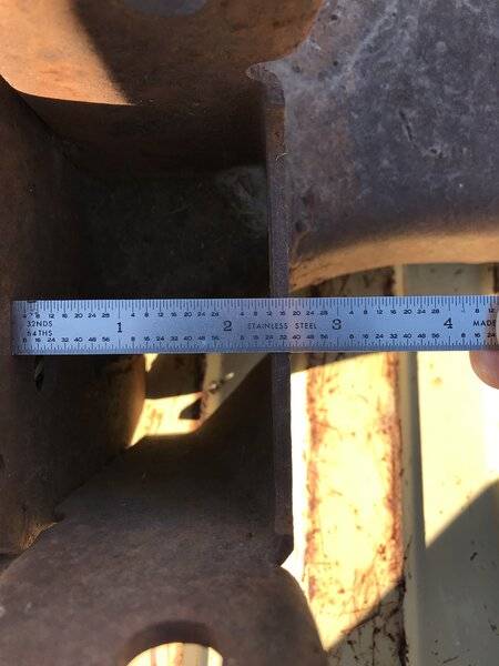

Driver side measured just under 2-3/8" . Passenger side measured 2-9/32". In production, this dimension could easily vary more than 1/8".
Driver side.
Perfect! Thank you so much for taking the time to do this!
