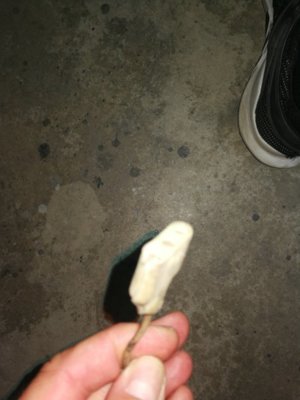

Looking for something similar. Was thinking electrical push in marrets but not sure it's a good idea. Anything better?

I'd like to connect 3 wires to 1 in same fashion. Doesn't need to be original
IIRC, the factory soldered connections like that then taped it up.......?
Something I could disconnect easily lol. I'd do that last resort of course
Dash harness has a triple female connector for male bullets below the radio.
No I mean looking for the plugs where I can make my own not where it goes
I wasn't saying where it went.. I was suggesting you can probably get one from someones old pulled OE dash harness.

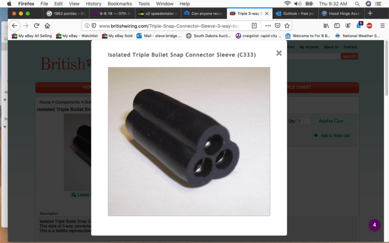

Triumph cars have a few triple bullet couplers in their light system.
