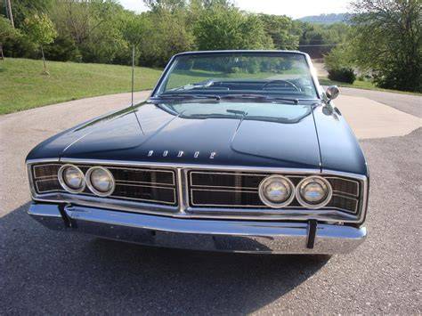

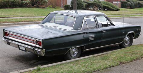

Just like the title reads.. I heard there is a difference in 66 to 67 Coronet/Chargers and don't remeber if it's front or back or both... Pics describing would be great also. As always Thanks in advance.
The guards are:
Different front and rear
Mounted in different places each year-out further in 1966, closer in for 67.

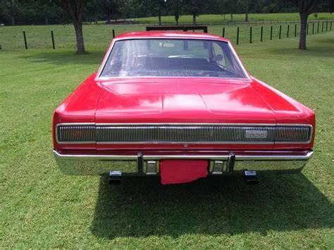

I don’t know for sure. So speculation is the rear bumper is straight across so they should be the same.

This is where I am thinking they are different but want to know for sure...

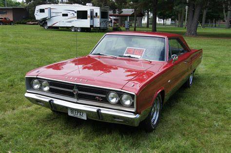

On 1966 Charger and Coronet, optional bumper guards lined up with the hood and trunk opening seams. Since there was no convenient bumper attachment hole here, it meant providing 2 extra holes in each bumper face for the guards. I imagine Chrysler would have to stock separate bumpers for each application. Merely drilling a hole in a solid bumper would lead to eventual failure in the chrome plating around the drilled hole. In 1967, Dodge decided to mount the bumper guards on existing bracket attachment holes. This required new/different bases. Looking at original, period pictures, the rear bumper guards were mounted on the outer bracket holes to provide maximum protection from parking mishaps. My 1967 Coronet R/T had its original bumper guards when I bought it, and the rear guards were attached this way. I thought they looked dorky this way, and I moved them in-board on the other bracket hole. This more or less balanced the look of the front bumper guards placement. Looking at pictures of restored '67 cars, just about everyone has done the same thing for better looks.

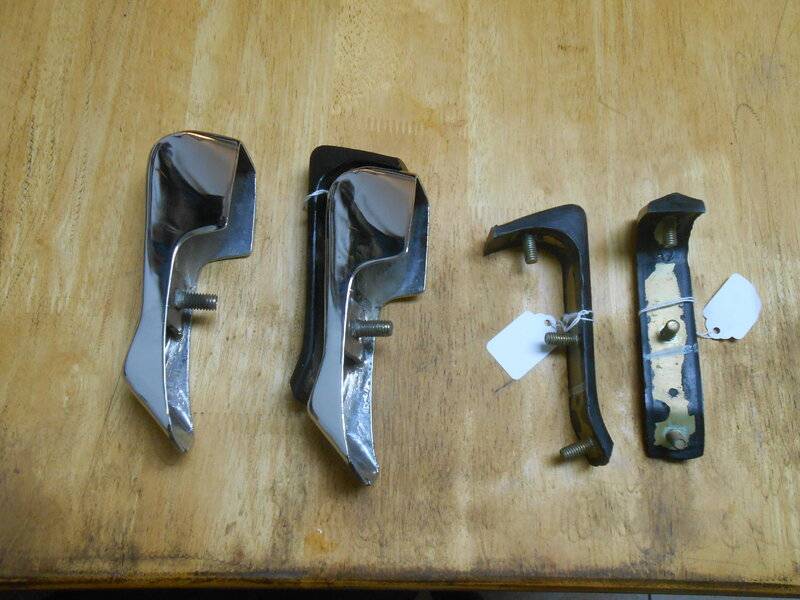

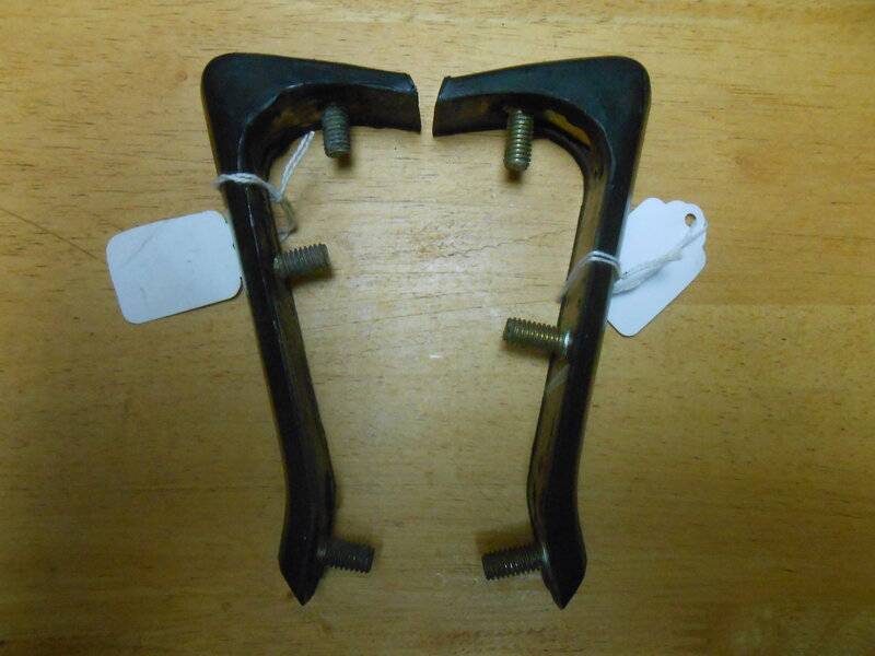

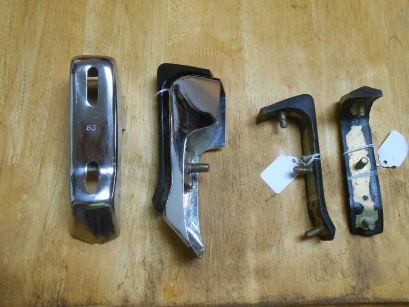

I will explain why I ask afterwork Wednesday with pics... 66 Coronet Front guards are taller than 67 models..
There 2 different bumper guard cushions used in 66-67.. It looks like what I have below are nos 66 only front bumper guards (2nd-3rd pics). They take a cushion that has a larger spacing (close to the top stud) see first pic. Then it looks like 67 rear only cushions are the same as 67-9 Dart. Just want to know exactly what I have. Anyone think anything else let me know.. Thanks!
View attachment 1115420 View attachment 1115421 View attachment 1115423
Anyone confirm???
