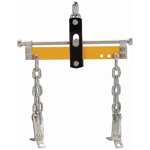

this made pulling out the tranny with the engine way easier
