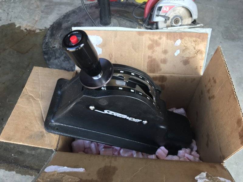

The shifter that came with the trans came with a button installed on the top which I presume is for the brake.
Also I have a msd 6al I like the 3 step you have maybe I’ll go that route.

The button on the shifter will probably be used for the water box chip.
I mounted my Moroso Adjustable Transbrake button onto a bracket under my dashboard (as you can see in the attached picture. Easy to put my thumb on, and no wires to get wrapped up in the steering wheel.

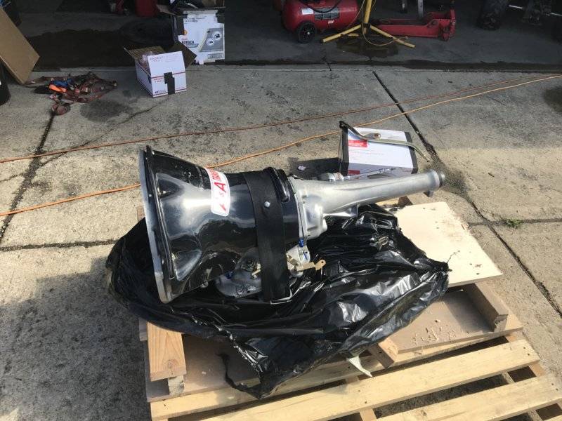

Yes it is, just trying to figure out if there’s any little details I need to know about it. I was browsing some other threads and seen some things like, no rolling down shifts without a rear band apply. I’d hate to wreck this thing first time I get it out.
