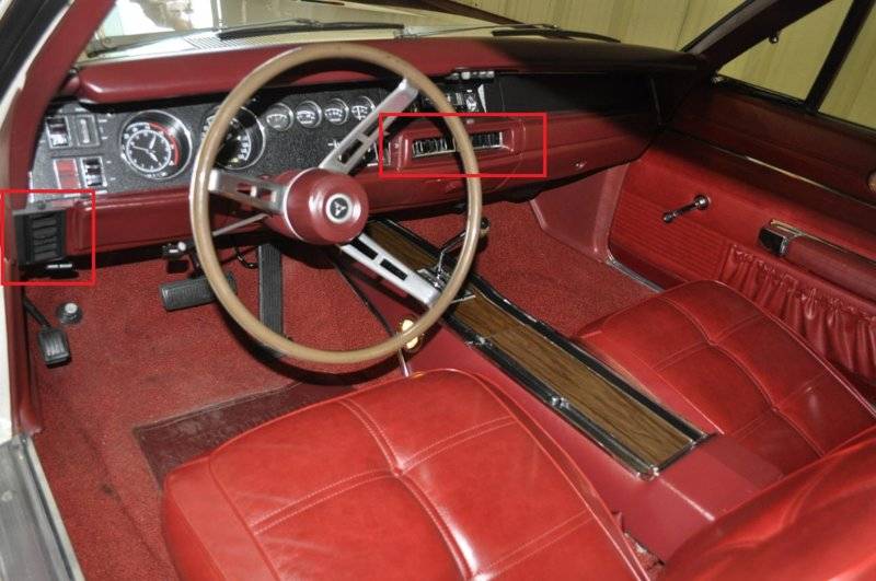

AC Car:

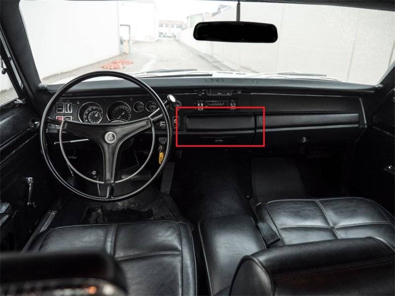

Non AC Car:

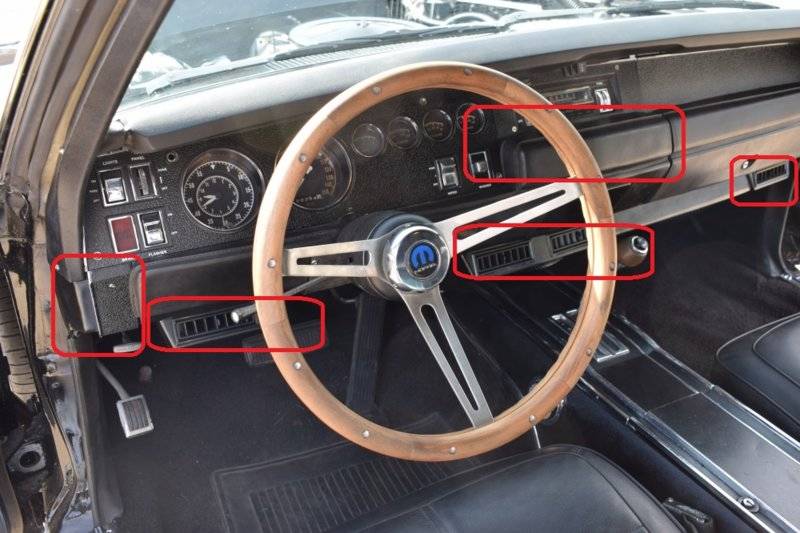

Here is a car with the retrofitted Vintage Air AC System.
As you can see it has the (aftermarket) Vents retrofitted under the dash.
I do not want something like that.
So my Question is can you Remove the Covers from the Non AC Dash and swap them for some Vents like in the AC Car or do you have to swap the whole dashboard/use underdash vents when using an aftermarket AC like Vintage or Classic Air AC?

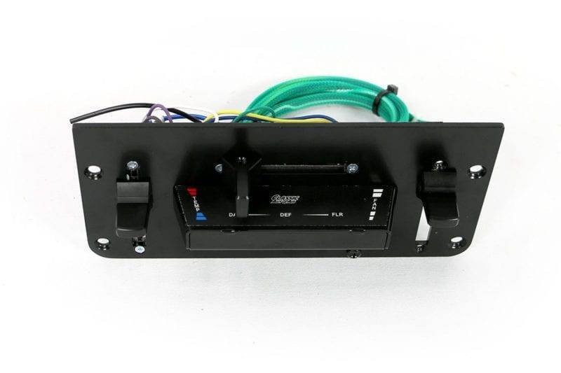

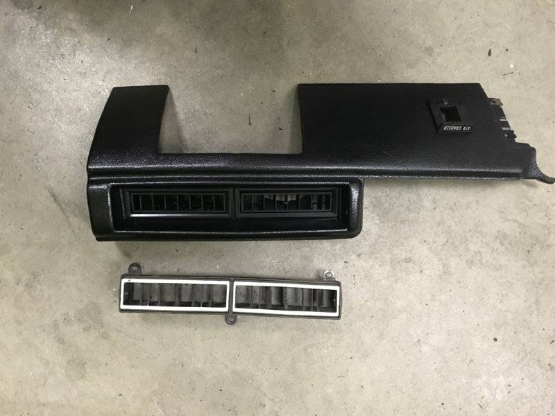

Yes, the Classic Auto Air Kit has underdash vents to use in non ac cars. I purchased the piece show in the first picture with the red interior. A Princely sum of about $400. Not installed yet. It included the center piece, a routing box that goes behind it, and the 2 outside vents that will require dash modification. FYI, the 69 vents are metal, and the 70’s are plastic but look the same. Go by the weight if purchasing. Got it in Van Nuys from Daryl Finch, Wrightwood, California. Desert Auto parts. Overpriced with nefarious reputation. But, he has the STUFF.
You would need to buy dash parts that came from a 68-69 B body that originally had A/C to get the "in dash" vents. The one in the center is a dash mounted "pad" that might actually be available as a new reproduction. The ones at the sides of the dash are likely to only be found as used parts.
Okay so its possible to use Vintage Air and Classic Air without underdash Vents but i would have to buy the Dash Parts from an AC Car.
Thanks for the info, thats exactly what i wanted to know. :)

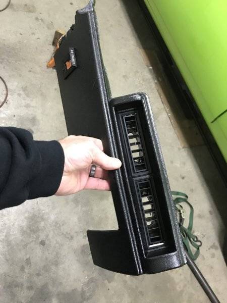

No repro of center soft with vent. Seller told me he had to cannibalize 3 units to put together a working vent.
Classic Auto Air has the center vent setup for those that can accept a non-OEM look. Most people won’t know the difference but it’ll be obvious to the purists. A little time spent with a chrome marker would help disguise it.
