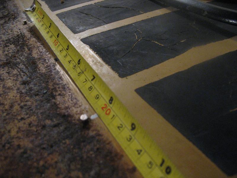

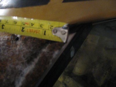

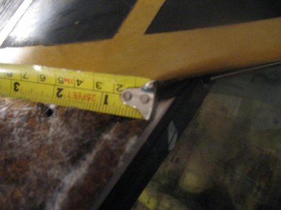

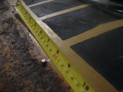

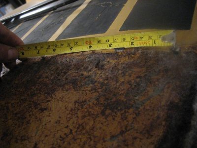

This was sent to me today from FASFISH,
I'd like to publically thank him for going out of his way for me and taking the time to photograph and measure where these holes and rivets are located for the Canopy Top Rear Molding.
Ron Sannino
(hooked onto the corner of drip rail , the hole of first clip is 2 inches to
center... this is the clip with the nut.... the next clip snaps on a peg which
is 6 and a half away from hole and the next peg is eight inches from that peg
and the last peg is also eight inches away from the prior peg........ start on
the other side of the car and work up fron the drip rail the same way to locate
the rest of pegs..)canopy top rivit6.jpgcanopy top rivet5.jpgcanopy top rivet4.jpgcanopy top rivet3.jpg
