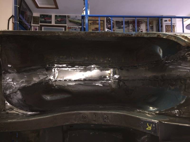

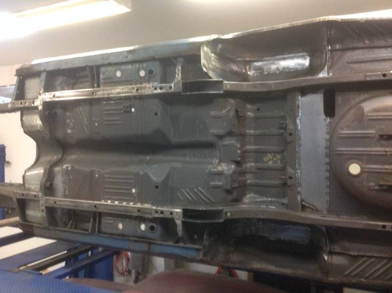

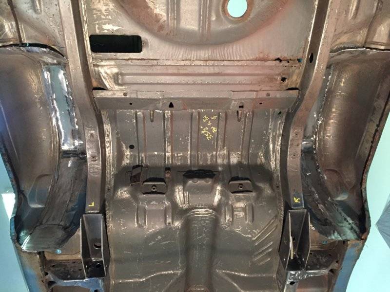

malex, can you give us a close up of the tubes working on my tub layout would be a big help. did you weld inner well right to frame. thanks barry
Yes I weld the inner tub onto the side of the frame. You'll be dealing with a compound curve when you lay your metal in. I welded in the new metal in 3 pieces on the Dart, it worked good.
Will replace the quarters later later. Hope this helps you.
