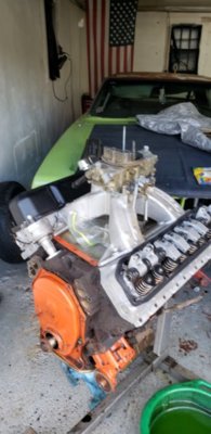

Using the stuff from my GTX.
cam is hydraulic roller .584 I believe and 1.6 rockers.
Checking p/v clearance if I get home early enough today.
I just sat everything on the motor temporarily for the pic.
73 cast motor .
Pistons sit down good in the hole.
Hopefully it works
