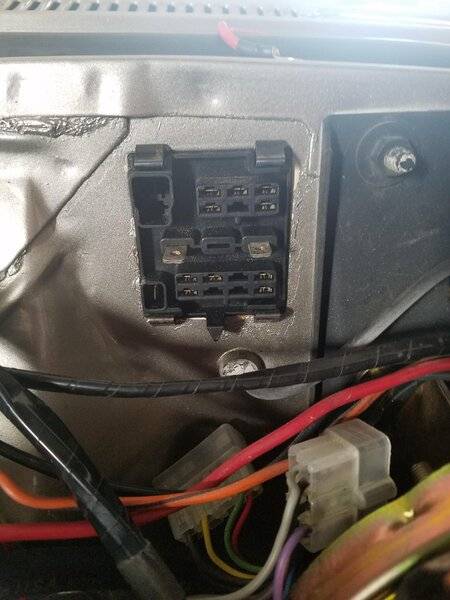

So, a lot of answers about the bulkhead connector. I looked at it today and the fusible link connector is corroded and the violet connector next to it is a little corroded. Do I pull the individual wires out of the bulkhead and clean them or pull the whole bulkhead off of the firewall and take it apart and clean? BTW, thank you for all the responses and ideas. I will check all this stuff out.

My thought is if you found one corroded wire there are more. for peace of mind, I would go through the whole thing.
An important part when you are done: Use dielectric grease packed in all the connectors when you put them together to avoid this in the future!

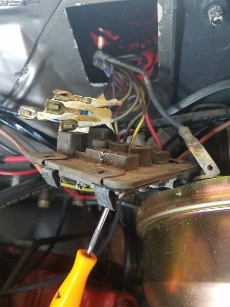

I pulled the connector apart and sanded both sides as well as I could. Very thin sand paper 400 I think, worked great until I completely replaced it.
I'd say ya got a lot of fine advice. I had on going hassles with my ignition wire post new engine harness and figured the old skanky BH was likely an issue. I pulled out the old BH installing a new one. I was happy to find the original female connections were in fine shape, gave them a vinegar bath and some sanding stick treatment, then using a mule male prong refitted each connector to get rid of any slop. I noted that the ig wire had been getting undue heat due to poor connection. Packed with di-el grease and good to go...ahh for a while! The demon came back! After some scalp scratching pulled out the ig wire from the 'new' engine harness to find one effing shitty crimping arrangement as the wire came free from the crimp. So re-did this and reconnected - so far - so good. I'd say (to state the obvious) quality matters when getting engine and other harnesses...I could tell ya another story on this with my rear harness tail light sockets. Crap! Also added an extra ground wire that solved a problem in the rear. Yep, assure solid-solid grounds, assume nada, and check all wiring connections for premo fit...anything 'old' double check...could say ask how I might a learned...

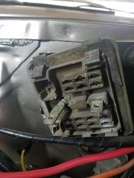

I tore the bulkhead apart today and found lots of corroded connections. Most notably the fusible link connection. In fact, when I took the middle gang connector off the fusible link connector broke off it was so corroded. So I got a new fusible link and some replacement GM56 connectors and will put it back together tomorrow. I also got a couple of new ballast resistors, one installed and a backup. I'm going to do the amp meter bypass but not till I grow balls big enough to start tearing into the dash.
