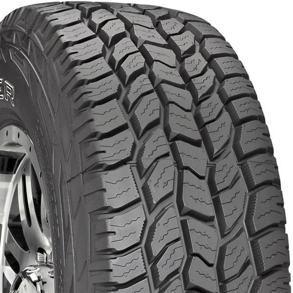

My '59 Apache runs on 15" rims. Currently I have Cooper Discover tires on it, that are 33" tall 12.5 inches wide and a pretty aggressive tread pattern. They are noisy and like to "grab".

do you agree with my assumption that a less aggressive tread will be a better ride?
Absolutely, and unless you're going off road, those tires just wear faster on the pavement.
I have those Coopers on my 2500 Ram and they're not noisy at all. Not as wide though 265/70 17"
