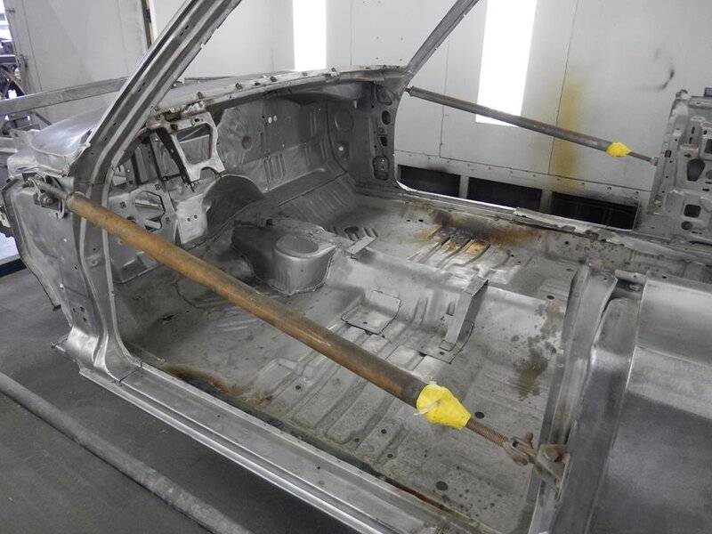

I think my friend built on or modified one. had extra cross bars going across the bottom where you would get to the floor boards. makes sense for a convertible resto!
I have hard top that is getting underfloor frames rails and torq boxes etc etc. sounds like i should get something sturdy so i'm not welding to a twisted, distorted or moved unibody.
I always like to check here before making ill advised purchases and bad decisions so i can blame my self later.
this one wasn’t made special for my car. All the welding was done with stiffness welded in at door jambs and across interior before now getting on rotisserie.

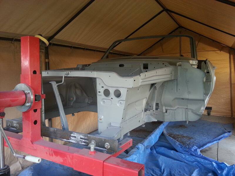

Check out post #85 on "73 Roadrunner 340 Auto" for the rotisserie I purchased and the one I probably should have purchased. Good Luck on your project.

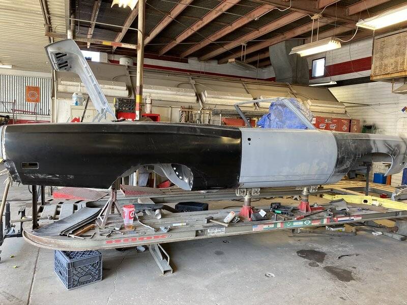

If you are like me, I don't have room or the $$$$ for a frame jig and a rotisserie. Yes, it would be best to have a frame jig to replace the items you mentioned (underfloor frames rails and torq boxes etc etc) but it is not the only way. If your plan is take the car down to the shell you are probably going to need/want a rotisserie to make your project much easier. And, if you already have a rotisserie then this might work for you. Limited resources/space requires some thoughtful solutions. https://www.bing.com/videos/search?...D89208E26183EE66A3A2D89&view=detail&FORM=VIRE
Anyway, it is just one idea. As always, do your research and find what you are comfortable with.

Ah the RTS3000, it has a lots of options!!! it has b body leaf spring mounts? i like the off road casters but, for $500 the seller is making boat payments. def looking at this.

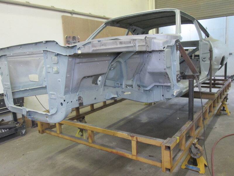

Torq boxes should be easy, these are the US car tool rails that go under the floor boards.

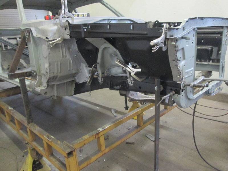

Very few body guys use a "frame plate" - they're more for race fab. You can do just about anything with a simple but well-made frame made of 2 x 2 tubing. And it doesn't have to be LARGE - basically something a little wider than the frame rails of the car and the length of the car is sufficient as the base.

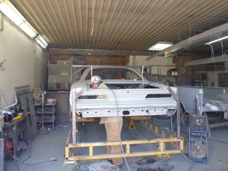

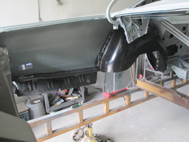

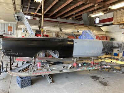

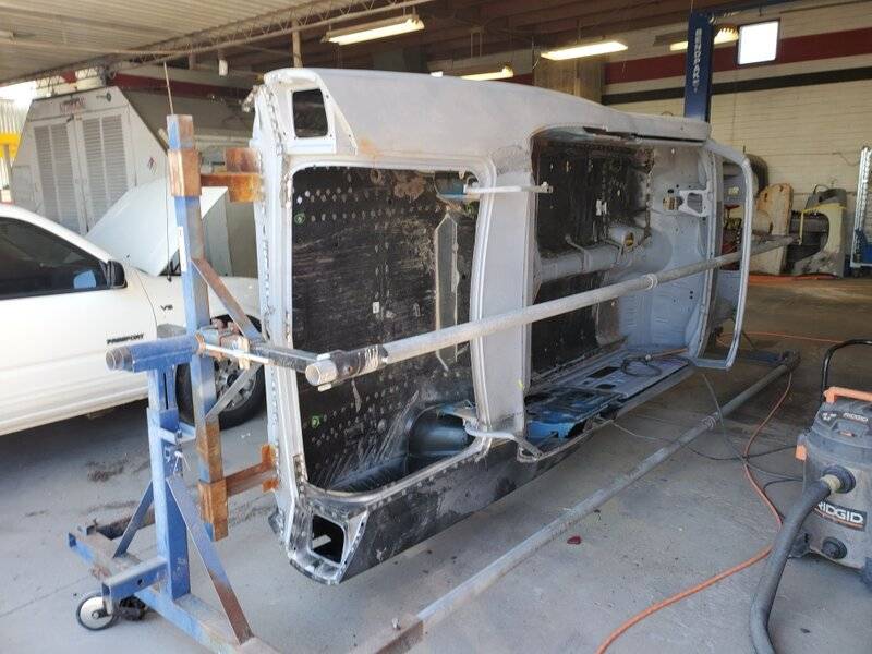

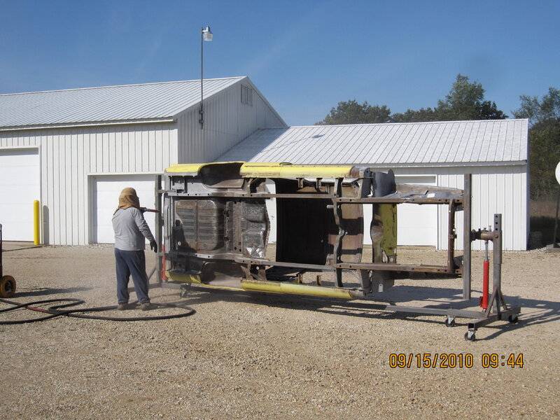

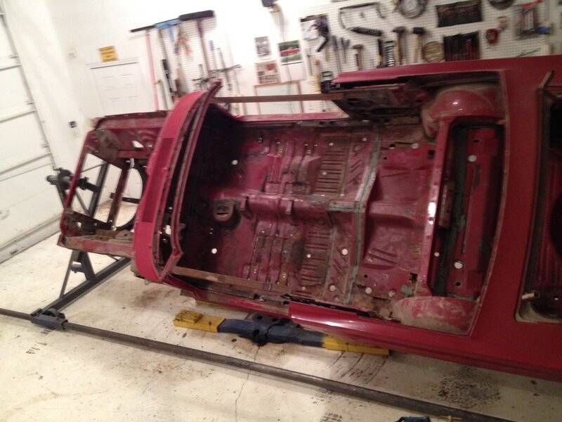

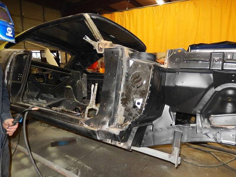

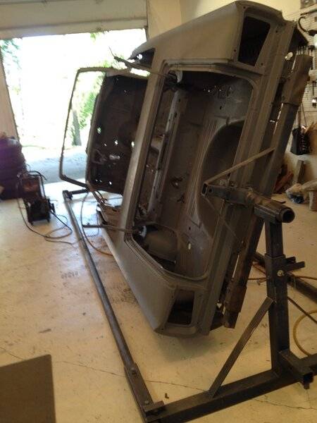

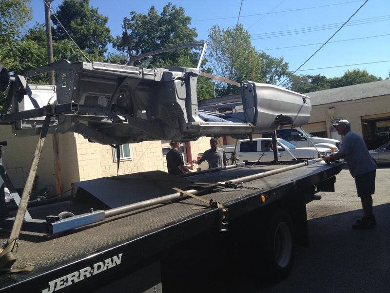

Here are some shots of the 66 Coronet Convert on the Rotisserie, it looks like a very similar one to Jack above. When we had to do some more serious welding, it went to a buddy of mine and we put it on his Frame Plate he uses to build Rock Crawlers. I can tell you that doing a restoration with a car on a Rotisserie vs on Jack Stands is like night and day difference. In my old garage, I had a single post lift that went up to 6 ft. I preferred having the car body on the Rot rather than the lift. But.... you got too have it stabilized so things don't move. Here are some pics. One was for Taking the car apart. WOW, was it handy for that chore. Second is it went to the Blaster on the Rot. The guys there loved having it on the Rot. Then back in the shop as we begin to do metal work on the body. Best, B.
"Ah the RTS3000, it has a lots of options!!! it has b body leaf spring mounts? i like the off road casters but, for $500 the seller is making boat payments. def looking at this."
Yup, I thought the road casters were on the $$$$$$ side of things. Could always add a set of HF road casters if needed. The crank and the heavier steel is what I was looking at.. I balanced my car spot on and could spin it myself when I first mounted it. Now, as more and more pieces come off, I ran out of balance adjustment. I can still spin it myself but it takes a little more effort and I wouldn't want to let go of the spin handle. If I had the crank, I could just crank it around. Other than that, I really like the unit I got. I see it is on sale now, figures. Note: I was really sold on the stabilizer legs but now that I have used it for awhile, I wouldn't be concerned about tipping. FWIW

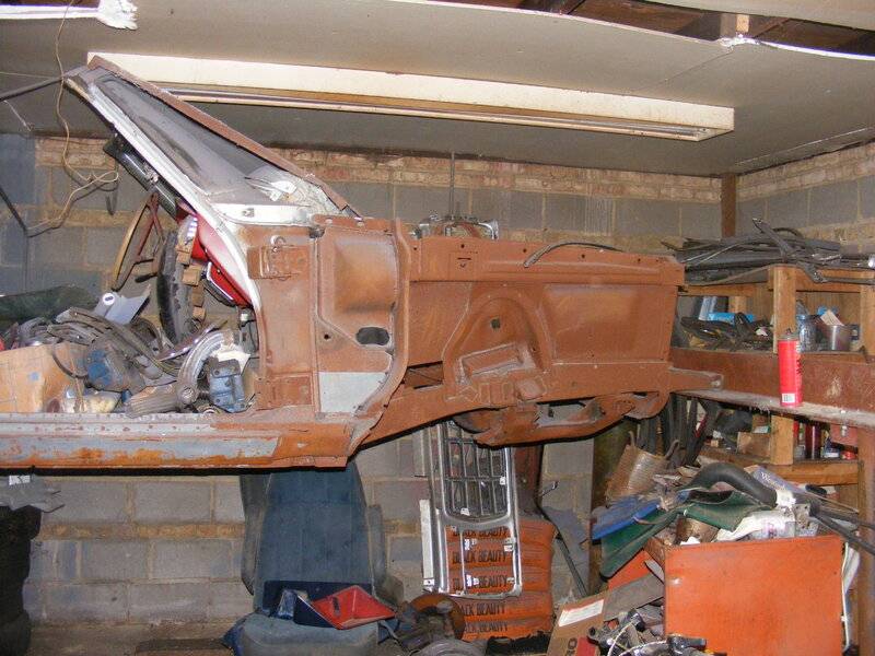

Yes i was afraid if i had welded them when there was flex in the car the door would not fit. My uncle planed on blasting it in the 80s but he never finished just left is hanging to develop surface rust. It actually sat on I beams bolted to the bumper mounts for 30 years up in the air. After that i put it on my rotisserie and got
it back on 4 wheels the car returned to the correct position. Im guessing if you have a soild car and are not cutting out panels you will not end up with permanent twisting damage either that or i was lucky.
