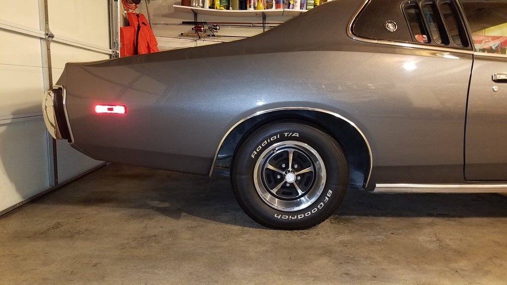

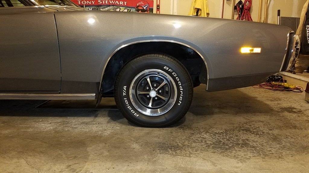

This car has never been touched in that regard its completely stock never been cut up.
If that was my car I would turn the front bars down. Way too much fender gap on the front IMO. Rear looks good where it's at. If you put new springs on you may end up with the same ride height you have now.

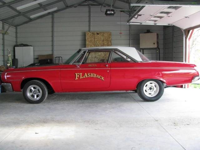

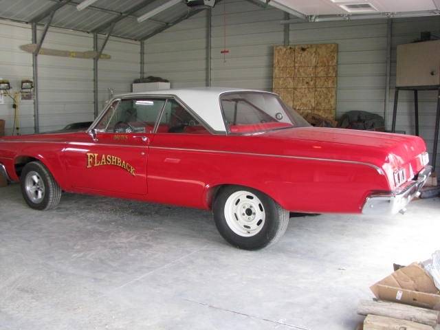

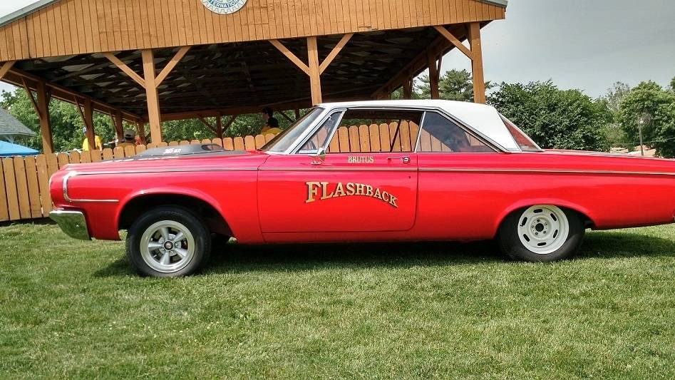

I just recently put new springs on the back. I wanted the nostalgic raised look, so had the spring company make them to heavy duty specs , and it rides good as stock. They were made in Omaha Nebraska. $300 for the pair , which included new front eye bushings. and $16 for all new rubber shackel bushings. ...............................MO
