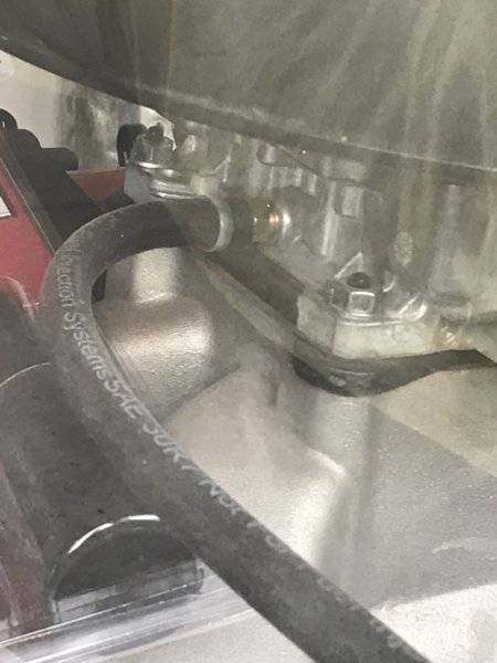

Make sure there is a plug in the rear of the carb base. In my case I have the PCV plugged into it but both of yours should have atleast the front one should be plugged off.
