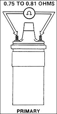

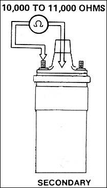

Coil (?) possibly too
MoPar Coil Primary coil test - to + posts 0.75-0.81 ohms secondary center to + 10k-11k ohms.jpg

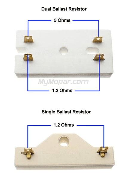

ballast resistor

I'd start here.
Disconnect both sides of the the ballast and test for voltage at the connectors per this.........
Sorry.. but just jumper the ballast (or pull one sides wire and jam it against the other) and see if it starts. No need for meters. If it runs.. ballast is cooked.

Ok here's what I found during testing. Ballest resistor 1.9 ohms, 1.5 ohms coil primary, 9000 ohms coil secondary. NO SPARK, plenty of gas. What should I replace or continue checking for something else. Many thanks.
