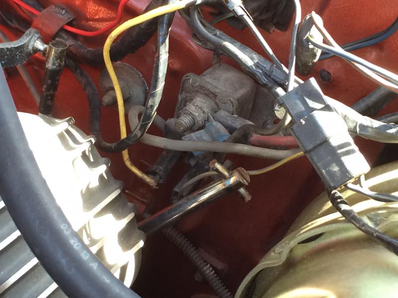

Ok I bought a test light and put it on this. Not sure but there is power running to the positive post. When the light hit both the positive and negative post the starter kicked over.
When I checked the positive on the starter there is power and when the light hit both negative and positive it turned over.
That is the starter relay in your picture. Get a new one. They can go bad and be intermittant. I have had a brand new one that would work a few times then not work. I thought it was a loose connection but it stopped failing when I replaced the starter relay. I would also clean the connections on the neutral safety switch on the transmission.
