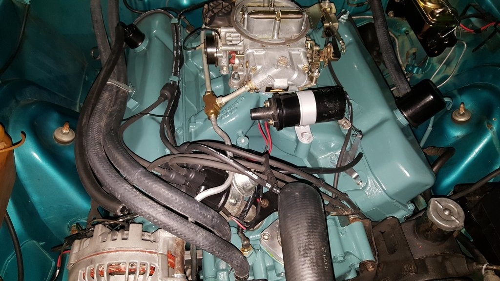

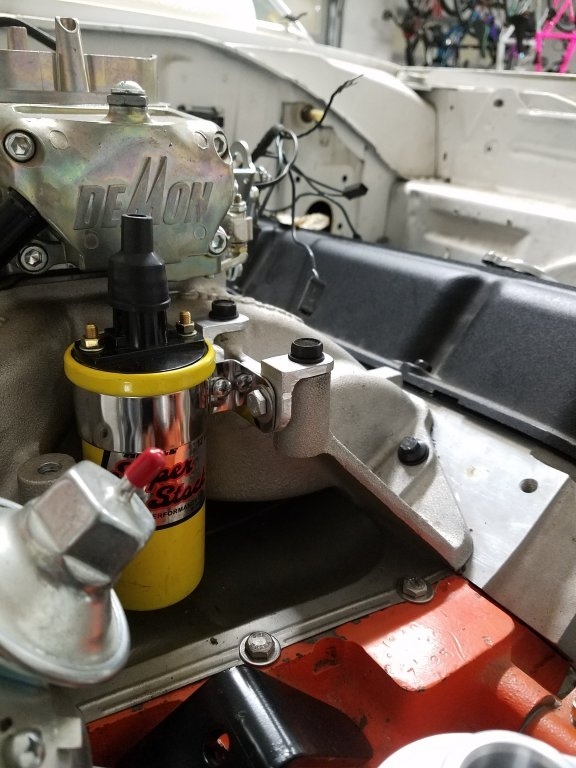

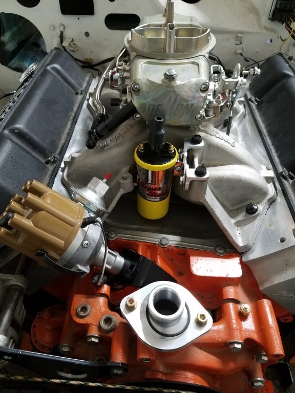

What are guys doing to relocate the coil when using a Holley in place of a carter?
...Started with a small piece of aluminum angle and took the drill and grinder to it, just needs to be cleaned up..I'll maybe paint the cheap chrome coil bracket and use different hardware

Get yourself a 3310 and go with the Edelbrock kickdown adapter. As far as the coil there's a guy that makes an adapter for mounting the coil when running the Holley. Also, you want to flip that AVS?
ARENGINEERING sells a bracket for mounting the coil with a Holley. PM
andyf. He can get you squared away.
Similar sort of build. 850 Demon works good. Street.
