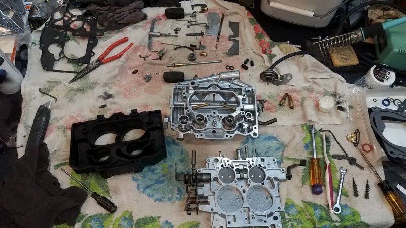

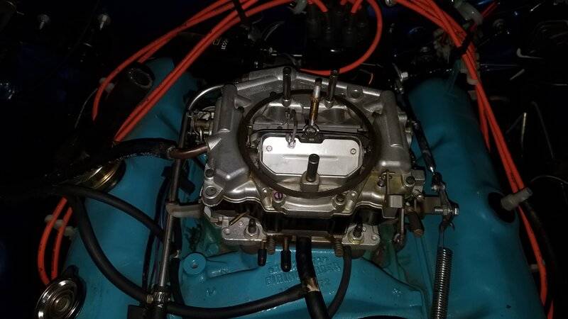

I think I am going to pull the carb and rebuild it. I will be at the Chrysler Nationals this weekend. What do I need to know to get the correct rebuild kit for it? Thanks.
I bought a rebuild kit from an Ebay vendor that was recommended on the E body forum. I tore it down yesterday and did the rebuild. It is running great.
