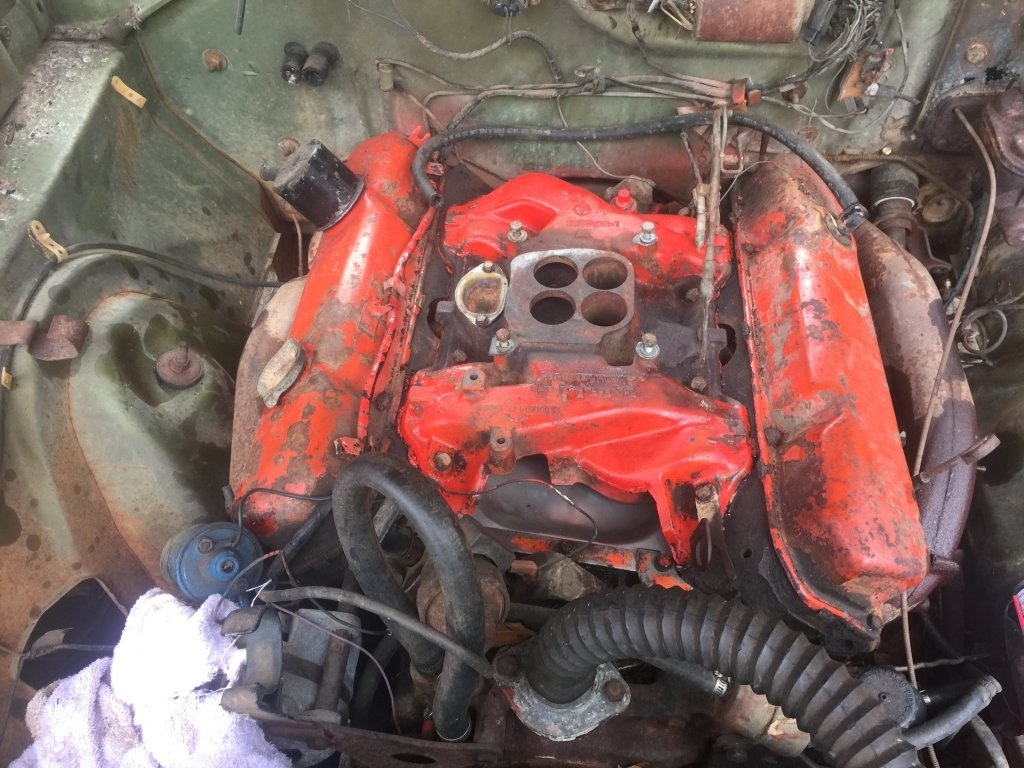

What carb's do you guys suggest with a 70 383? Assume it is a stock build at this point and just want to get something on it to run it. I was a little eager and bought a carb that did not mount to my intake. Intake is 2951666-1.
Thanks in advance.
Phillip
