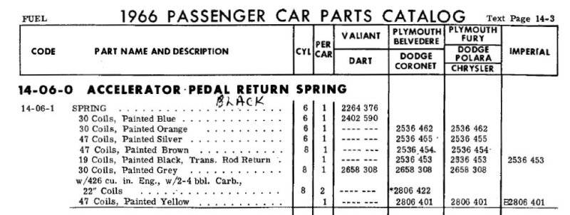

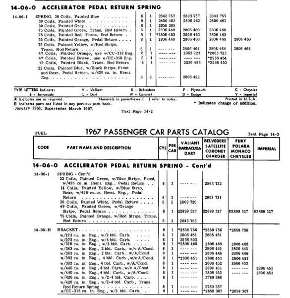

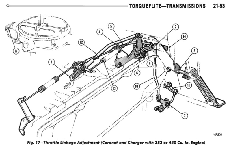

How can you tell what spring to use 4bbl big block(383) 66 charger. The 2 springs on linkage for throttle return and kick down as many are different, thanks glenn
