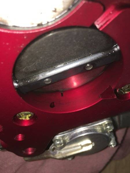

Hey I appreciate the suggestions I haven’t had a chance to work on the car til today first thing I noticed is my butterfly are open a lot more than the picture above. (Transfer slots aren’t squared) Does that mean it’s idling off the primary?

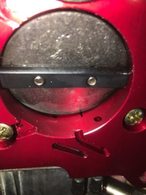

Okay I closed the transfer slots to small squares exactly like pictured in Paul_G post above. In order to do that I had to turn the choke and and rpm screw? To get the butterfly’s to close enough. I started it up and it runs fairly smooth, idle is low due to me having to turn the screw out in order to get the butterfly to close enough to create a square. According to my wide band gauge it’s still off the chart on the rich side at idle and leans out to 11-13.2 at WOT

Those throttle plates are open pretty far and likely idling in transition. Adjust the throttle plates closed a little until the slots look square. Primary and secondary slots should all appear to be square. Thats the starting point. Adjust all four mixture screws in until lightly seated, then back out 1 1/2 turns. The engine should start and idle now, check float levels and adjust if needed. Lots of videos on youtube for adjusting holley floats. Adjust the idle speed to what you would like the engine to run at, how is 700 RPM to start with? Engine should be idling fairly well at this point.
If the engine needs some fine adjustment, start adjusting the primary side mixture screws first, 1 mixture screw at a time, turn it in 1/4 turn, then try out 1/4 turn, whichever is better (smoother more stable and/or highest idle) leave it there and move on. Go to the other primary screw and do the same, then do the secondary screws. Repeat the process with smaller adjustment, like 1/8th turn until you have the best idle. You can also use a vacuum gauge doing this adjustment, trying for the highest vacuum with the smoothest idle, needle on the gauge holding steadiest. You may need to bring the idle speed back down if the RPM has increased substantially.
