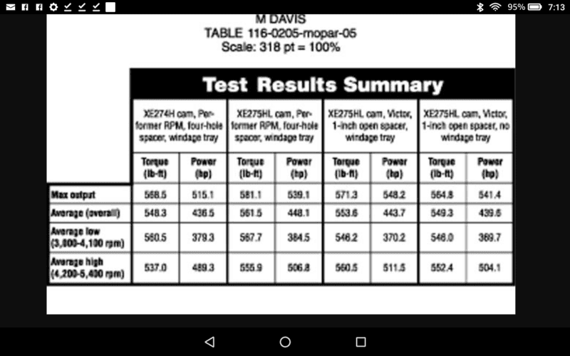

Mopar Muscle once did the same, and they did show gains in torque and that the power band simply shifted some. This was kinda the point of my post...dyno stories and conditions vs. a real world driving report. It's also why I tried to put up as much info about my combo as possible. Different setups, different results. A couple of things I didn't mention, it was a fairly dry and sunny 60° day and I run pump 91 (premium for us in ca). I didn't mess with my timing (20/36)

Here is a comparison of a 4hole and open on a 10.5 / Eddy headed motor
