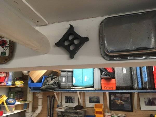

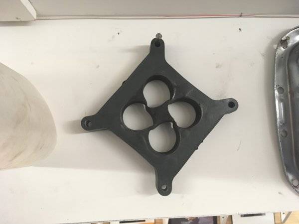

I’d be wary of running a 4 hole on an RPM, as that intake has no physical support for the center part of the spacer.
I have a pic somewhere of what happened to mine after a backfire.
Edit: found it...
