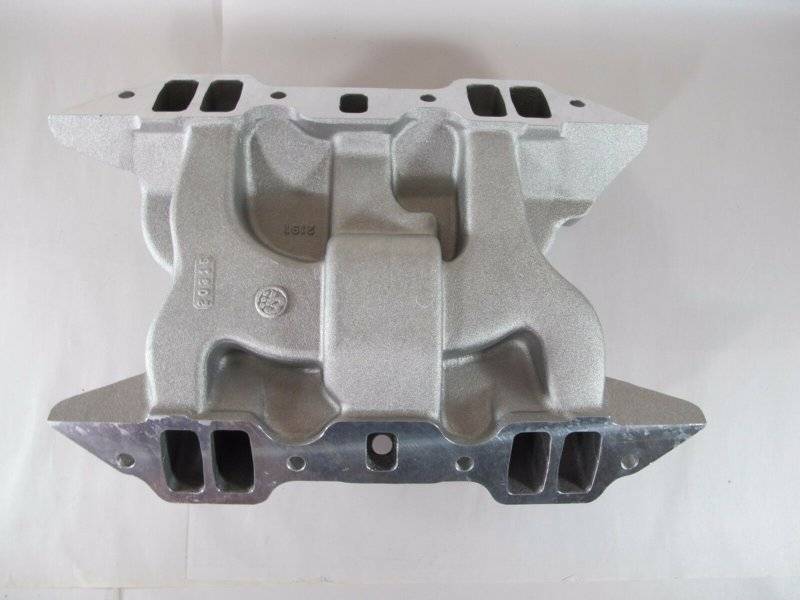

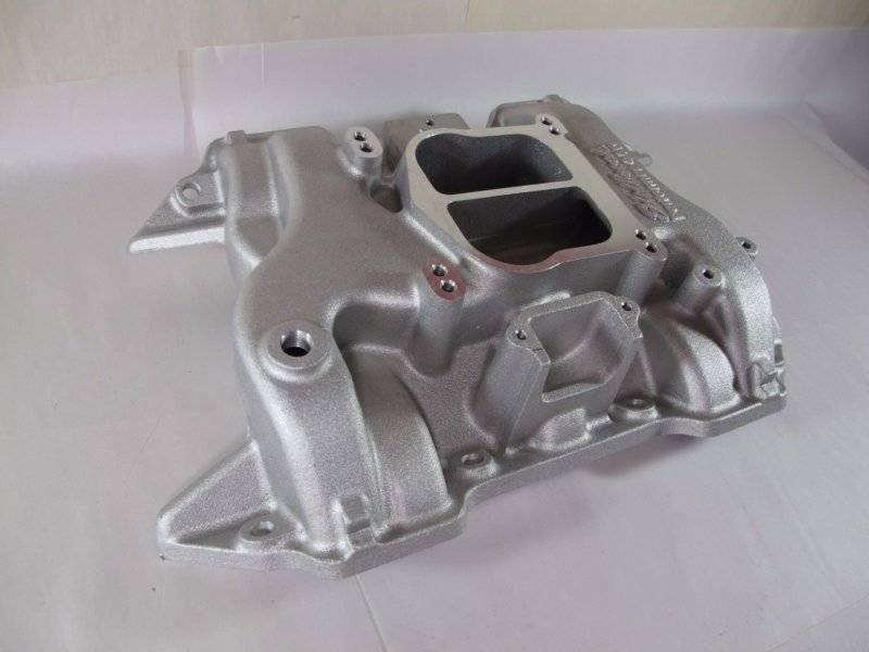

As rumblefish stated, that manifold is for a thermoquad carburetor. It does appear to have heat crossover, however, if you look at the choke well, the bottom is squared off while most choke I have seen are rounded. See pictures.
Here is the bottom view, shows the heat cross over.
Here is the view of the choke well. notice its square on the bottom

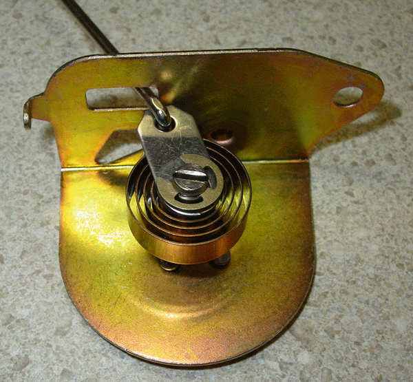

here is the style of choke that should be used, but its rounded off to fit a stock manifold
Looking at some other setups with this choke, the rounded part may overlap the square bottom on the eddy manifold.
