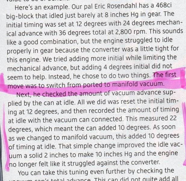

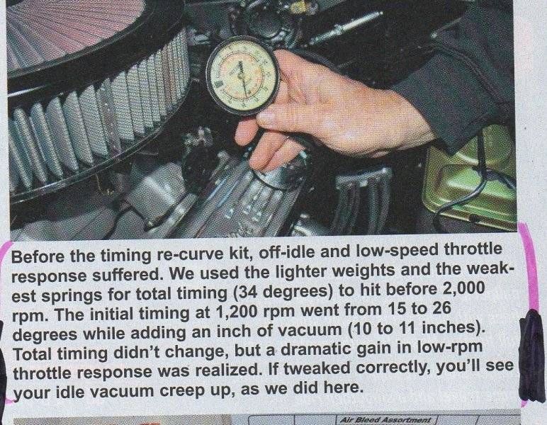

With a Carter AVS there is only one source for distributor advance, which is ported. You shouldn't be pulling any vacuum at idle anyway using that source. The 727 pump is spinning any time the engine is rotating since the converter hub engages the pump lugs. Line pressure is lower in park (0-30psi) than in neutral (57psi).

If the cam is installed at 107 degrees intake centerline, and with the 228 duration on the exhaust the idle vacuum is normal. Raise the idle with the gauge connected to about 2,000 rpm steady and you should see 18 to 22 inches of vacuum.
Hooking up to an intake vacuum nipple is providing full time manifold vacuum to the distributor so it would be pulling in vacuum advance at idle.

Sounding good,but,,,, too weak advance springs in distributer? It’s been a long time for me to remember & my FSM is at my youngest son’s.

If you want to keep it simple, using an adjustable vac adv unit is the easiest way to do this. The VA unit gets plugged into a manifold vac source; you said there is a port on the rear of the carb that feeds the air vents. You can get a Tee piece & plug into that. Everything connected to it will not be affected. If you have a Chrys dist, it may already have an adj VA unit. The adj VA units have a hexagonal sectional just behind the nipple. If it is round in that area, then it is not adjustable. It MUST be an adj unit for this to work. While there is some time/fiddling to get this working, the better running engine will be well worth the time & effort. I will wait till you report back on the VA unit.
I would suggest that you still verify your total advance (base and centrifugal) with vacuum advance disconnected. You are assuming all the centrifugal is in by 2500 rpm and maybe it is and maybe it isn’t. But a lot of Mopar distributors contain a delayed advance spring (heavy gage spring with a loop instead of eyelet on the end) that doesn’t go into action until fairly high rpm and then it slowly allows more advance clear up to max rpm. It sounds like you may be getting detonation or pinging where you are at. I use pump premium my stock 68 440 motor and it can’t tolerate more than about 34 max centrifugal + base timing w/o pinging. You may need to look at the springs in the distributor or test the engine at higher than 2500 rpm to make sure the advance is really topped out at that rpm.
