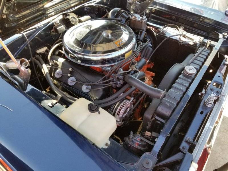

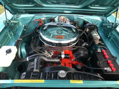

If your Hemi car is anything like mine, getting rid of the corn won't take long at all, but will give you a few blasts thru the gears. Once you have some good stuff in it the tires are next in line. I just had both carbs rebuilt on this one and it must have added another 50 HP kick in the butt. View attachment 763799 View attachment 763801
Looks like this.
66, 67, or 68? Hard to tell from the picture, but I wish the one in the picture I sent you had the power steering. If it's a 67, I think I know the car. If it's the one I'm thinking about, I know it's capable of burning the tires off, because I have seen it do just that at the strip in Columbus, Ohio at the Mopar Nationals. The color is telling me something. Beautiful engine bay!!

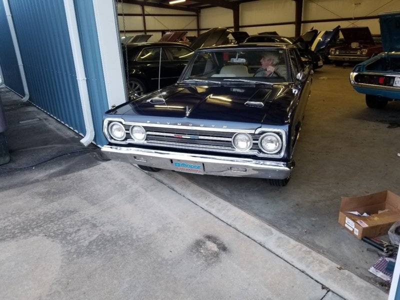

I picked this pile up at Barrett last month.

Super Nice and definitely not a pile.

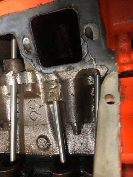

Well, my hard headedness payed off. After pulling off plug wires one by one number 1 and 8 were maybe 25 rpm drop. Figured something bigger was up.
Pulled the valve covers again to measure actual valve lift thing=king maybe wiped cam..They were all right around .370"
Popped the intake off and found 1 and 8 intake gasket looking like this. And it has a repaired block. See number one intake pushrod guide.
