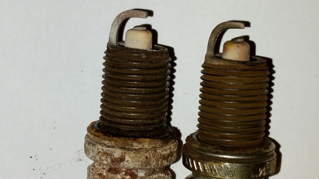

I think this is the cause of the misfire codes on a 2002 RAM 1500 4.7 I am working on for a neighbor. These are the two plugs from the cylinders with specific misfire codes, but the rest of the plugs are not much better and probably why its also throwing a general misfire code P0300. I have never seen plugs this worn out before, guessing they have never been changed!
Just curious if coils on each plug should be replaced, looked around for some testing, and not certain about it, so if anyone has any recommendations to test with VOM, let me know.
4.7 Calls for plugs every 30K on A and B schedules I believe.
If the plugs solve the misfire no coil change should be necessary.
Leave the coils alone, plugs should do the trick. Clean that throttle body while you're at it, they get nasty.

I had a 2002 Ram with the 4.7. I went 163,000 miles with it before I sold it. The truck still ran and drove great but I wanted a 4wd. I changed the plugs about every 30,000 and they had worn electrodes like that, though mine never ran rough or threw a code.

To Idrivemopar - Yeah, these guys are right. Change all the plugs & I'd suggest a good fuel injector cleaner at the same time since a mis-fire can be fuel related too. Looking at those plugs, I'd say that's likely your problem with P30xx codes.
IF you still get a code on one cylinder, say P0302, THEN look at injectors. A trick I use is to switch two injectors, clear the codes and see if the P0302 code changes to a P0303 code (for example) following where I put the injector in question.
Looks like the new plugs did the trick, she runs smooth, loud and proud, it has a single exhaust with just a resonator, and she blows nothing but water out the pipe, and gets up and goes now. A far cry from before, where it felt like she was gonna stall and barely had enough power to pass another car! LOL Im still amazed at the wear on the plugs!
