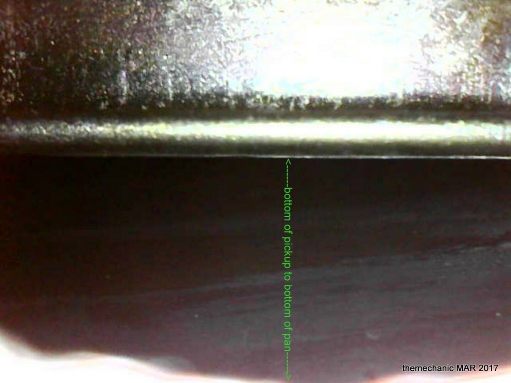

I used this today to check my oil pickup to pan clearance. The oil pickup to pan clearance can be checked with the pan installed and the pan empty, of course.
Here's a photo I took inside the pan looking through the drain hole using the USB camera and my cell phone:

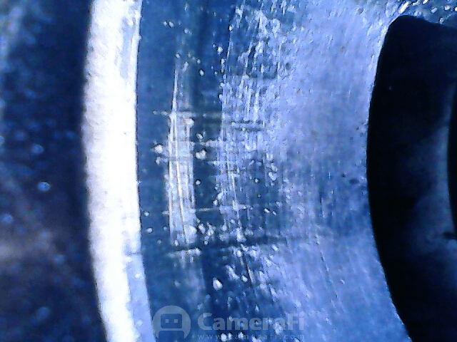

Here is the inside of my chainsaw - only has about 3 hours work on it - cheap Chinese engine, so bores are quite rough;

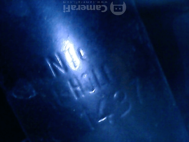

I also found it useful looking for the part number on my KONI shocks for another member recently;
