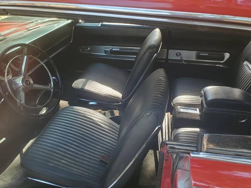

Any way of finding out factory options on this? I picked up a 4 speed model and is currently shipping to me, but it has no console arm rest between the front seats, but the back one is there intact. Pictures only the shifter stick with the chrome trim around the base, and nothing between the driver and passenger seats. Seller stated that's how the car came according to the previous owner he bought it from. I have the vin but no way of deciphering it

It could come that way. A buddy seat was optional in 67.
do you have a broadcast sheet? Fender tag?
Every 66 charger came with a full console and front and rear center armrests. We got so accustomed to seeing that we forget that the 67 console changed to a short one like a coronet with no armrest. Or no console at all.

Take a seat out and see if the brackets were torched off the tunnel. If there were no brackets.... you have a damn rare one..

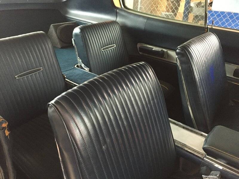

I have one more thing to add to this post, those front seats don't look like they have the emblems like the back seats? I know my 67 has the emblems on both the front and back, but now that I have looked at pictures on the internet some cars had the emblems and others didn't? I wish my Charger was a 4 speed car
So here is my 66 i have now low and behold the seats are the same these are originals
originals
A 67, if it had a console (buddy seat optional as mentioned) would only have one configuration be it 4 speed or auto. The arm rest would be there either way. Only difference would be shifter plate. Sounds like it may be from a 68 or 69 if it has a flat plate over glove box.
originals
Those seats are 1967 pattern. And if you look at the material the front and back are different. The factory installed those seat emblems on all 4 seats in 67 Charger, Coronet 500 and R/T.
Front seat skins, have newer seat skins installed, by the looks of them, hence, medallions are missing. Had a friend stop by, with a newly acquired 67 for an inspection, interior looked mint, and pretty much original. Until I actually sat in the car, the material looked very close, however, way to soft and spongy, albeit, I was comparing 50 year old material to new tech material.
