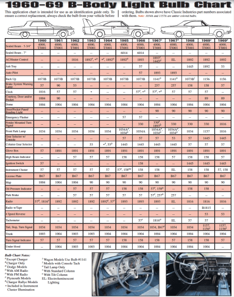

Yes SUN tach. The lenses popped off and I was able to super glue a piece of plastic to the bulb to be able to push in and twist it out. These are marked 06M. Looking for LED replacements
The console courtesy light bulbs are 90's I believe. This chart has missing entries but may be of help. I changed mine to LED awhile ago. Got some decent quality bulbs from Amazon. They work great.
