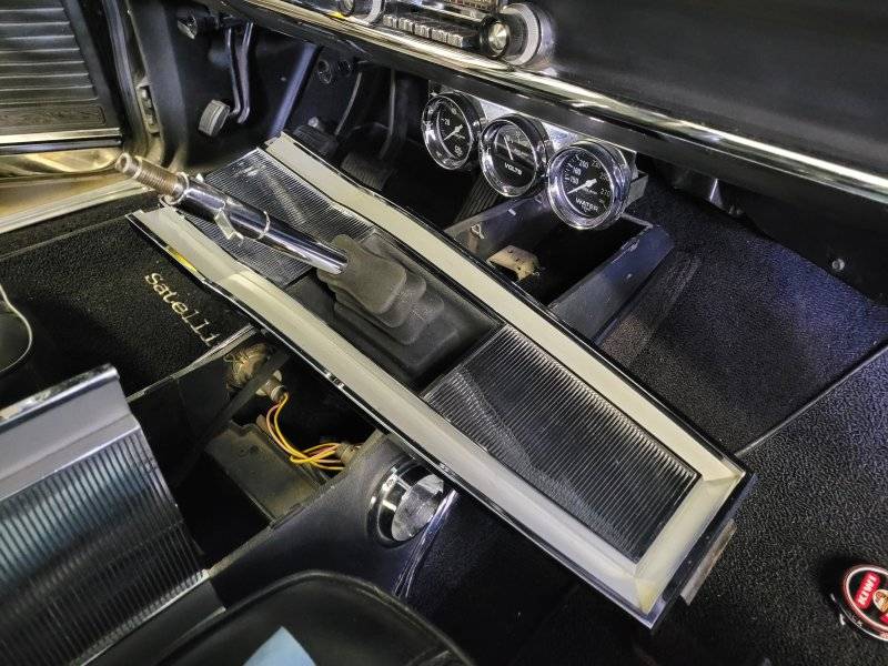

If you are only wiring you only need to remove the console lid. Remove the shifter knob which is held in place with an allen screw. Open the console door lid. There are 2 screws that hold the console lid. Remove them and slide the lid back off the front bracket. You may have to move the shifter to R-N to do this. Slide the lid off the shifter and you will see the wiring harness.
4 Philips screws hold the armrest lid assembly down.
Then the 2 for the front plate
