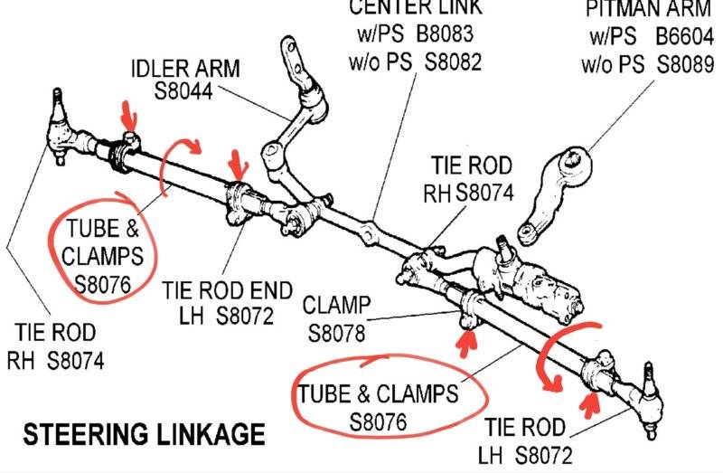

Loosen the clamps on each sleeve (red arrows)
Turn the whole sleeve to lenthen or shorten. They're right and left hand threads inside the sleeve. (tube)
With the steering wheel straight, look at the car from the front. Which tire needs to go in or out to make it right? Turn that sleeve to lenthen or shorten. Count the turns, maybe only a half turn at a time depending in how far your steering wheel is off. Then turn the sleeve at the other wheel the opposite way the same amount.
(This drawing isn't exact but close enough for an example)
Started to go looking for a drawing! And yep, it's close enough and excellent to see the tie rod ends and adjuster sleeves. The drag or center link is what's different. What kind of a car would use that setup??
The drawing could be a Ford Mustang.
Not familiar with Mustangs from 67 up but 65/66's weren't like that. The ones with PS had a slave cylinder but you could remove that and iirc, swap out the drag link and go with a manual setup easy enough. Column was the same too. Man, been a long time since owning one of those weak *** cars lol
just grabbed it off the net.
I edited my response to just a half a turn at a time.
