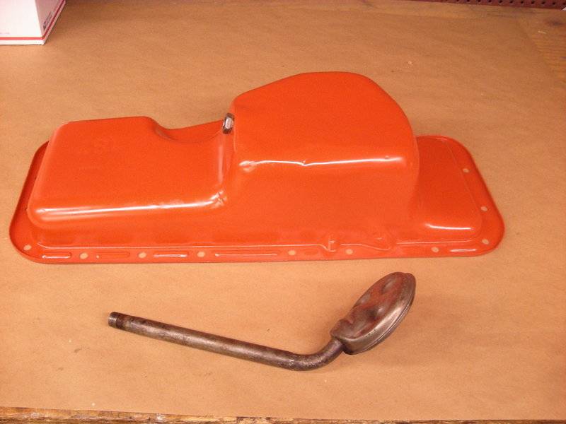

Here is a 187 pan and it has plenty of room. The Milodon from the rear of the block to the flat tank on the Milodon is 8 inches if I remember correct. The 187 has 11 inches from back of block to rear of tank.
