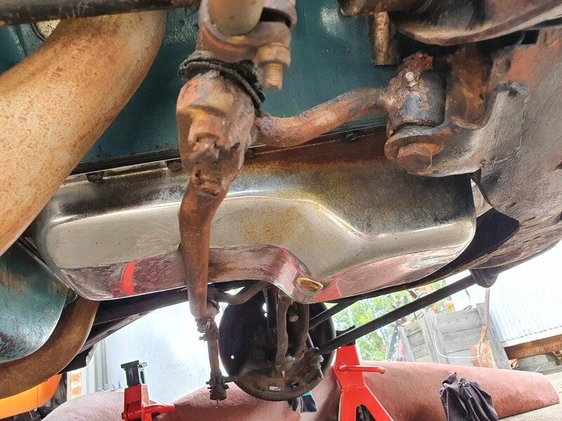

Hello All,
i got my roadrunner last week and it's getting compliance done at the moment so i can register it in Australia.
the brakes seem to've turned to crap so i'm getting them redone and while the mechanic was sorting this out he noticed that the centerlink rubs the oil pan even with the wheels straight........unfortunately i dont have any photos as i don't have the car however i will take some and update later.
any ideas on how to fix this....could i have a oil pan that's larger than normal, or could the engine be sitting too low (buggered mounts)....or could the center link be installed incorrectly.....

Even though it's an aftermarket oil pan, I don't think it's that. It's not that deep at all. Could be engine mounts, but the angle of that idler arm looks a bit off where it mounts in the k frame. Could be my eyes though.

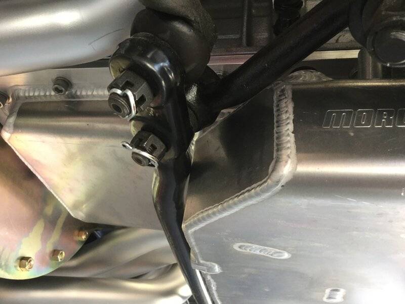

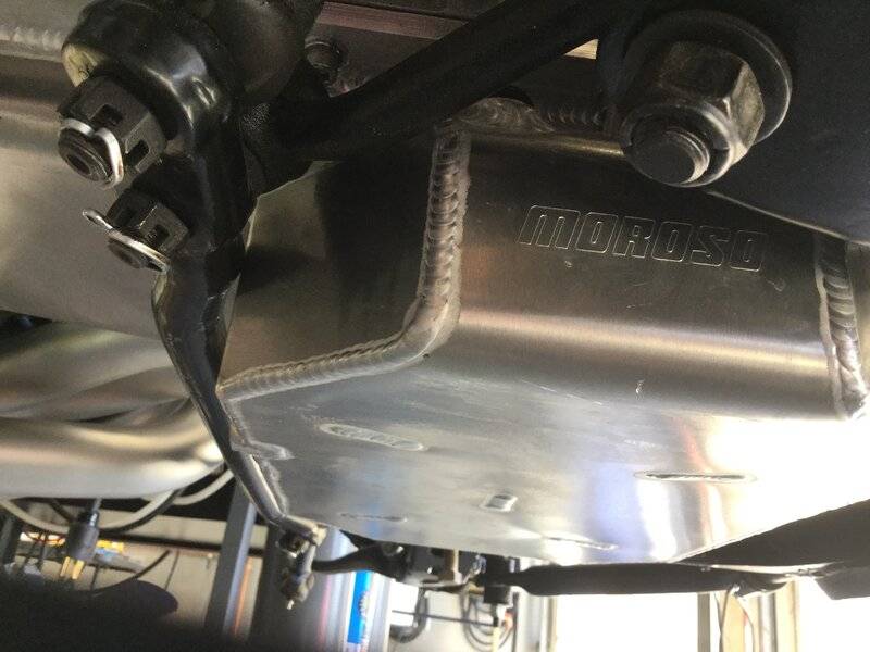

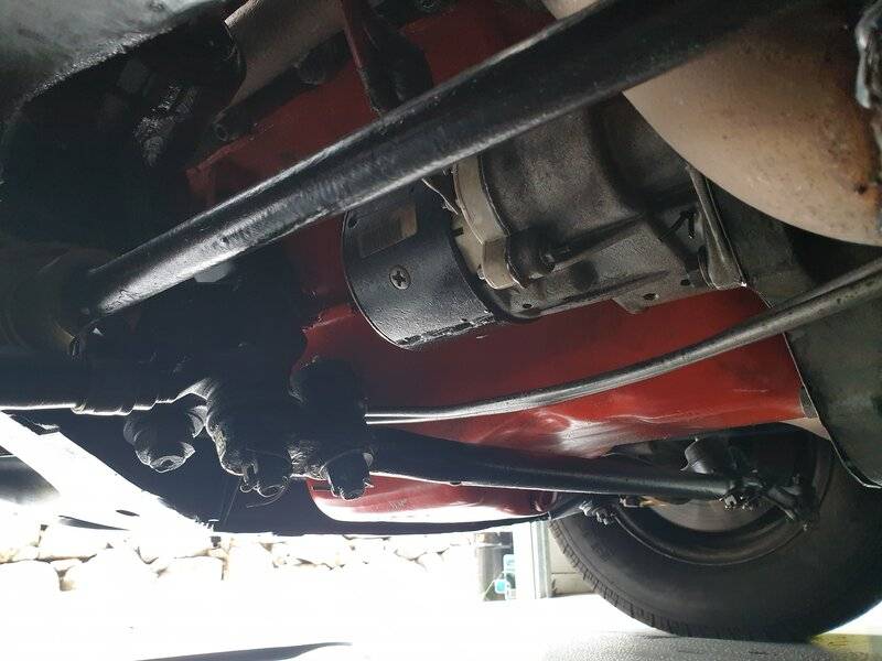

I've attached a few photos I just took under my car to show how much clearance you should have. It will differ from car to car (depending on engine) but it should be probably a half inch to an inch or so I would think.
Also have a check through your front end - some of those balljoints look pretty dodgy.

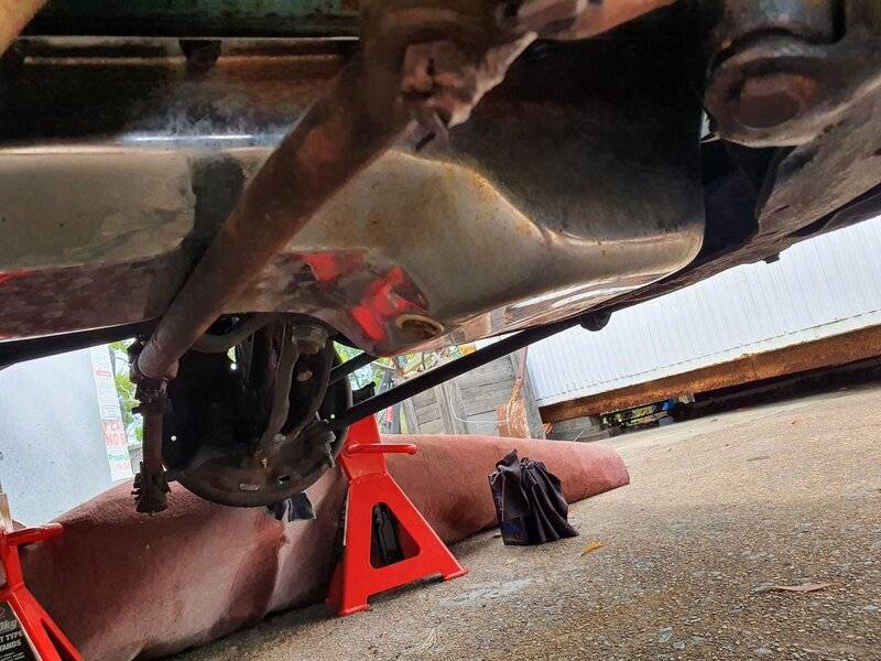

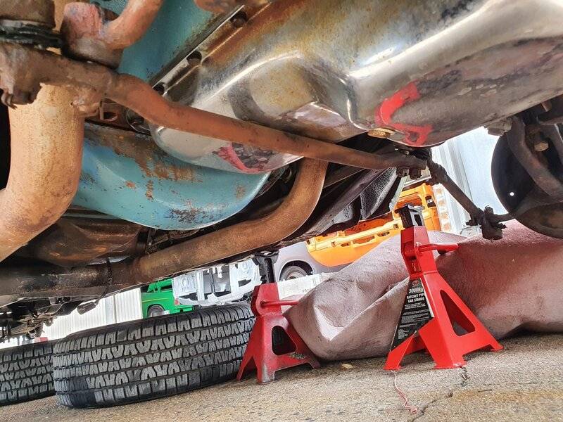

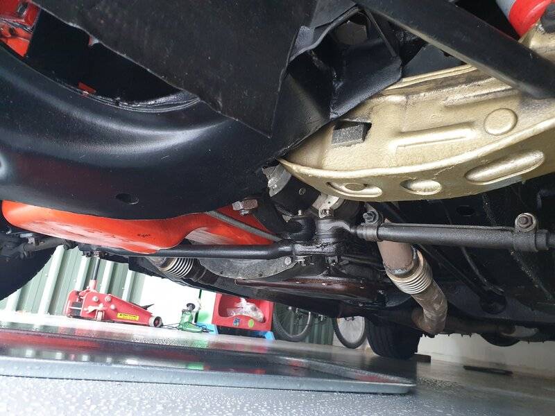

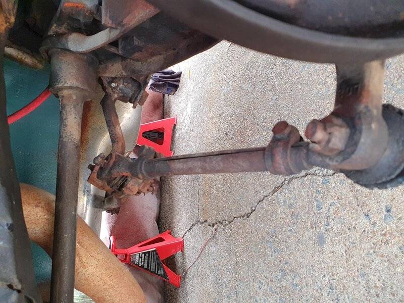

Same problem but with 72 Satellite with 440 transplant.
Was checking to see if mount was broken by jacking the motor up and found play/slack in mounting bolts. Able to lift motor a bit and tighten mounting bolt to keep pan off link, but only temp fix.
My rubber mounts might be too short, forget where I got them. Whole thing has been pieced together, so nothing is stock.
