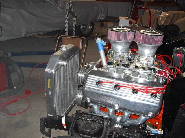

I used it on my TTI headers. I really liked the raw steel look next to the painted engine so I had them done in a silver that was very close. For me w cast iron exhaust manifolds next to Hemi orange, I'd go w a gray that's as close to the cast color as possible.
I don't remember Hemi Orange ever being available in CeraKote.
Most customers choose black, white or silver for exhaust applications.
I use on my headers and intake on my hemi, not hemi orange though.

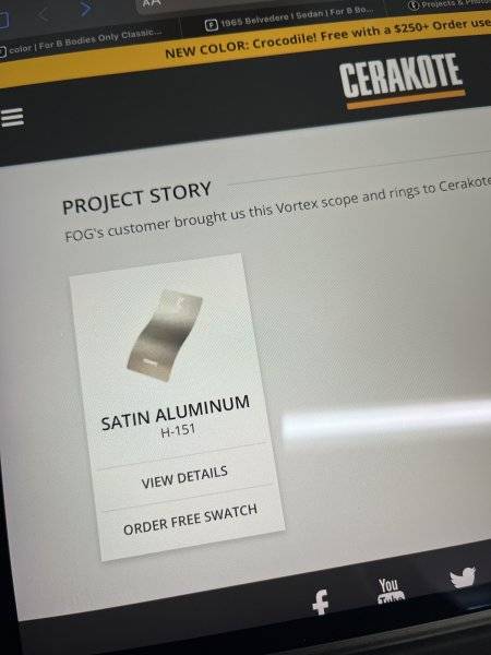

Thanks everyone,will look through there Colors but might end up doing a grey/silver to match the cast
Keep in mind there are SEVERAL different kinds of CeraKote / ceramic coatings available for many different things. Their website has a great system set up to choose the best one for any application; just answer the questions it prompts and you'll arrive at the best one for the job.
https://www.cerakote.com/shop
Yes will be using cerakote just wondered about color.I hate picking off internet as real color can be quite different it how it actually looks
I believe you can get a free color sample right from Cerakote…
